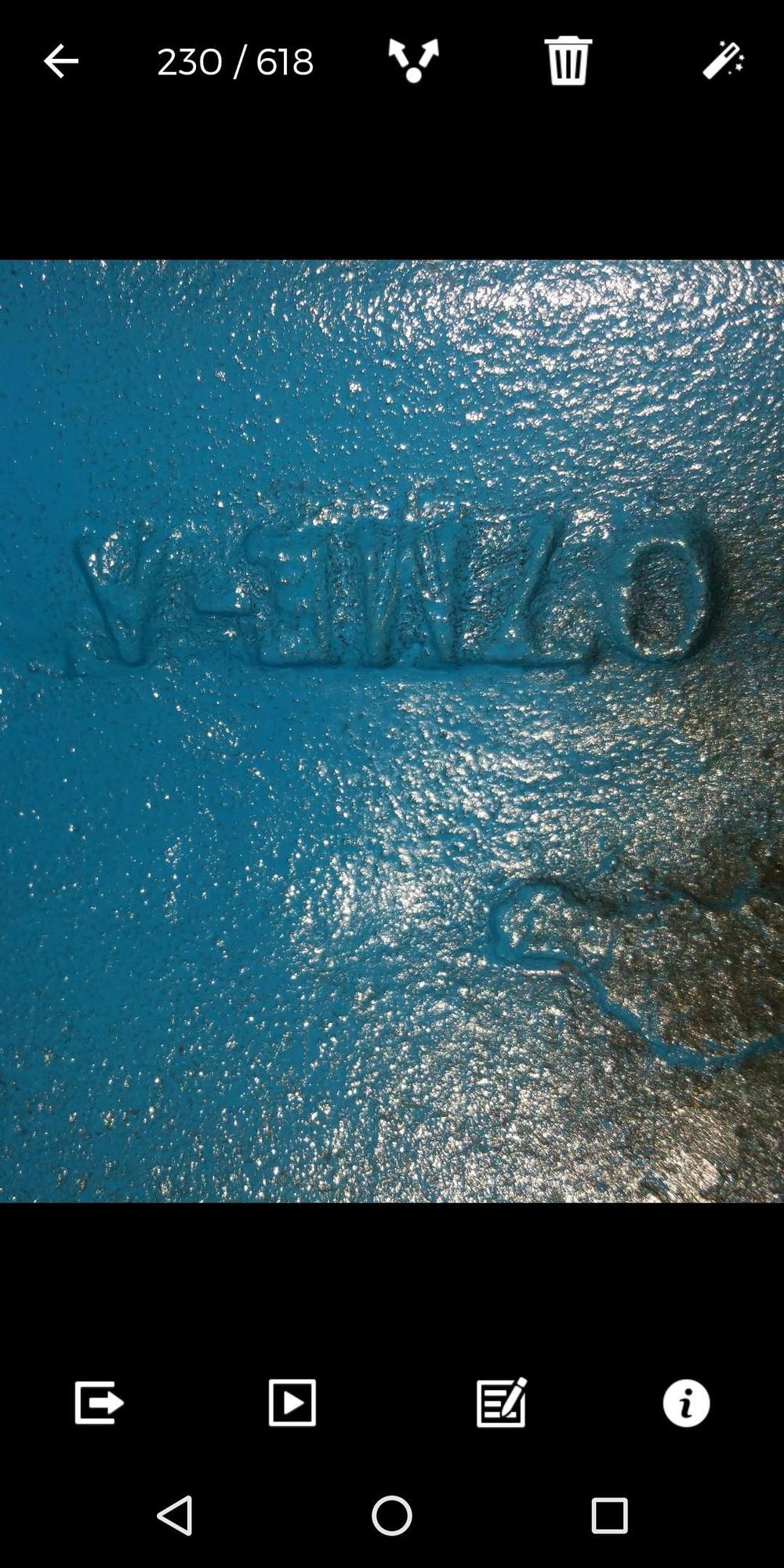

Old Mar 21, 2019 | 08:54 PM

Well that head was cast December 28th 1967. Still need to verify the stroke.

Sorry but I couldn't figure out how to add my comments with pictures. So, I think this is a 67 or 68 Mustang 390 with oem heads? If this seems right the story from my friend is gonna be 70 Ford F100. He put new bearings, rod and crank, rings, timing gear and honed and ground valves. He measured everything as tight and good to go. The girlfriend then said she wanted better mpg so he used a 302 instead, 3 years ago. I am pretty sure I will get this but still would like to confirm what it is if different than I think? Thanks

Originally Posted by ford390gashog
7M28: Well that head was cast December (M) 28th 1967 (7). Still need to verify the stroke.
A = January, M = December, the letter I is skipped. A cylinder head cast December 1967 would be installed on a 1968.
Notice the head casting number prefix of C8AE - This is: C8AZ-6049-M = 1968/71 Ford passenger car 390 2V/4V & 1968/71 F100/350 360/390 2V Cylinder Head.

So what would you make of this block? Be 360 or 390 and not a 330 mid size truck engine? Is there any idea then as to hp and torgue numbers? Assuming stock? I don't think that if it was the 330 I would want it because I read it's not really very good for what I have! Sorry if I am not that understanding of this.
