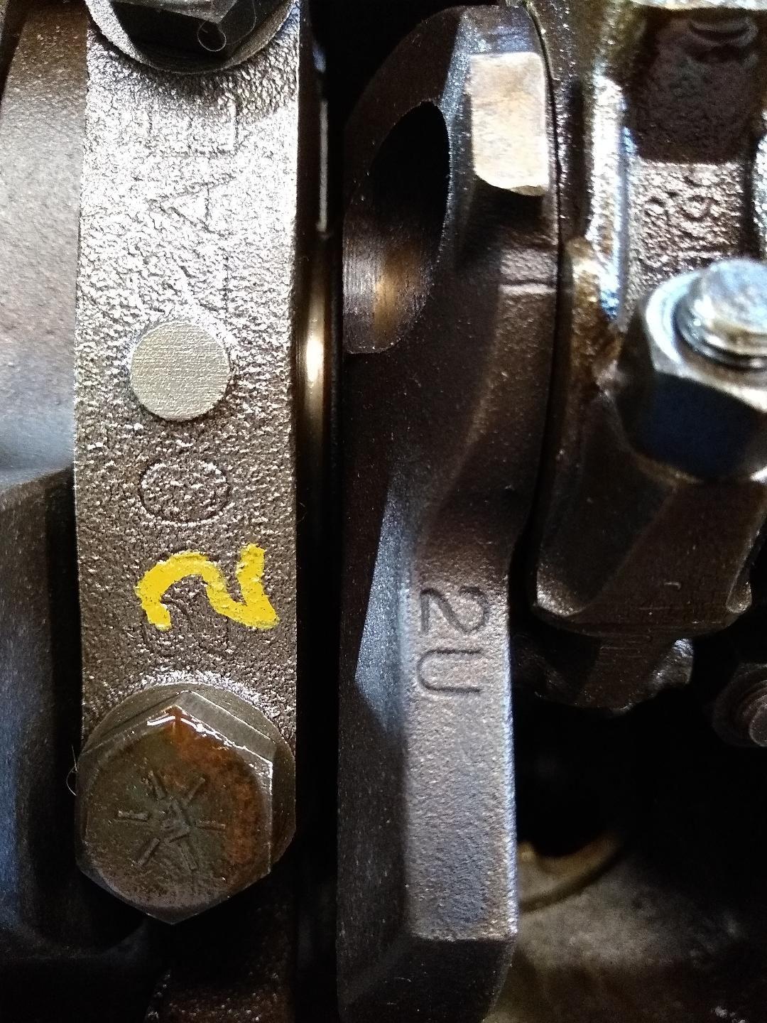

I picked it up today. I measured it and seems like it is the 390. I will turn it over tomorrow and inspect the crank for numbers and shape for confirmation. FuzzFace2, I was talking about transmission mount but I think I'm ok because I also got a last he knew working C6 with the motor for a total of 550.00. My trans needs rebuilt and It won't matter which one gets done. Here is another number? Does it mean anything?

This is the picture of the stamp on the crank. So this should confirm a 390.
