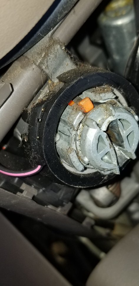

May have damaged the PATS transceiver ring or its wiring that "reads" the key.
When you try to start it does the "theft" light in the gauge cluster blink rapidly?

PATS images
Hi do these images show any obvious damage to the PATS systems?
