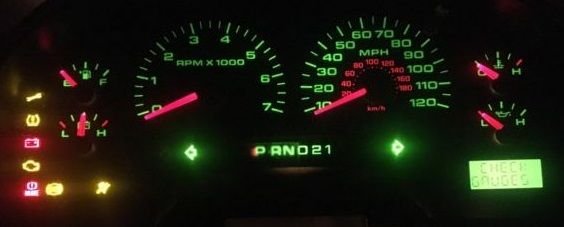

so after spoending close to a year dicking around with this truck i brought it down to be inspected which it failed because the check engine light does not come on. i am so sick of this truck. every time i think i"needs some work" special and i have been chasing my tail since thanksgiving 2017. i pulled the cluster assuming the crep i bought it from pulled the bulb for a quick sale but now i see that there is no bulb and it is in fact an LED sodered to the cluster circuit board. in fact, i am not even sure where th light is and what it looks like on these trucks. is it the wrench? does it look like a motor? does it say CEL or check engine? ugh. !!
So . . . back to the original issue:
Are there any codes stored?
When you turn the ignition from off to ignition on/engine off does the CEL illuminate for at least a couple of seconds?
I pulled a picture from The Google. It should be a little engine-looking shape in the lower-left corner between [brake] and [battery]:
