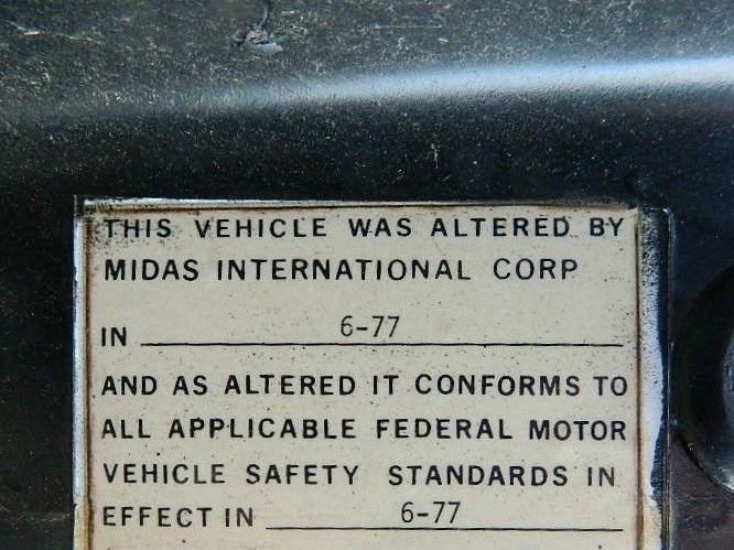

what does this sticker mean
on a 77 f150 f14s 4wd short wheelbase
thanks

Are you in California? Midas may have redone the exhaust and this certifies it?

I believe that Midas did conversion vans in the '80s and '90s, so they may well have pimped out other Ford models for dealer groups or whoever. I think they did camper conversions too. Is the sticker in a bare cab or cab and chassis?
I don't believe that they are the same company that sells and installs McExhausts, McMufflers, and McTailpipes...

its on the cab right below the vin sticker - not on the door - by the way - the plate on the door is missing -
is there any other way to tell what the specs were on this truck

You can decode the vin but it won't tell you everything that was on the plate. A marti report may give you the desired info. He also reproduces the door jam sticker and door warranty plate

Back in the 70's I worked auto parts business. I remember repair shops had to place a sticker in the vehicle if they replaced anything dealing with the catalyst system. But I don't remeber what that sticker looked like. Possibly?

From "Code of Federal Regulations: 1949-1984"
https://books.google.ca/books?id=2_w...all%22&f=false
