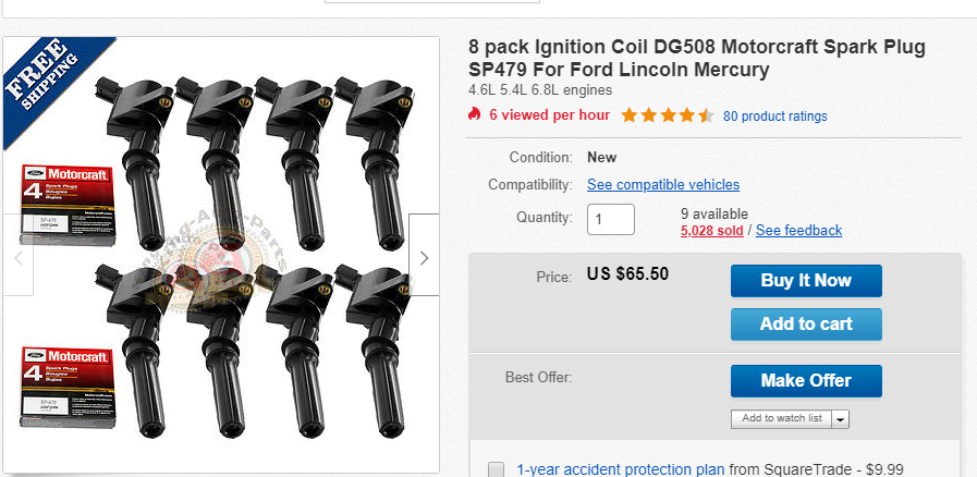

eBay 8 Ford Coil Packs. Seems like a good price for all 8.

I read the reviews on Amazon and someone pointed out that the coil packs are counterfeit. I ordered 1 real coil pack for a spare from Rock Auto. Additionally, I order 8 plugs and boots.

The ad you liked showing Motorcraft is designed to dupe people into buying Motorcraft PLUGS thinking the COP's they receive are also Motorcraft----gotta read between the lines. I've bought Motorcraft COP's through Amazon and eBay, typically paying just over $27 each. NAPA has a good brand of better quality COP's that run me about $50 each, I get the same price from the dealer.
