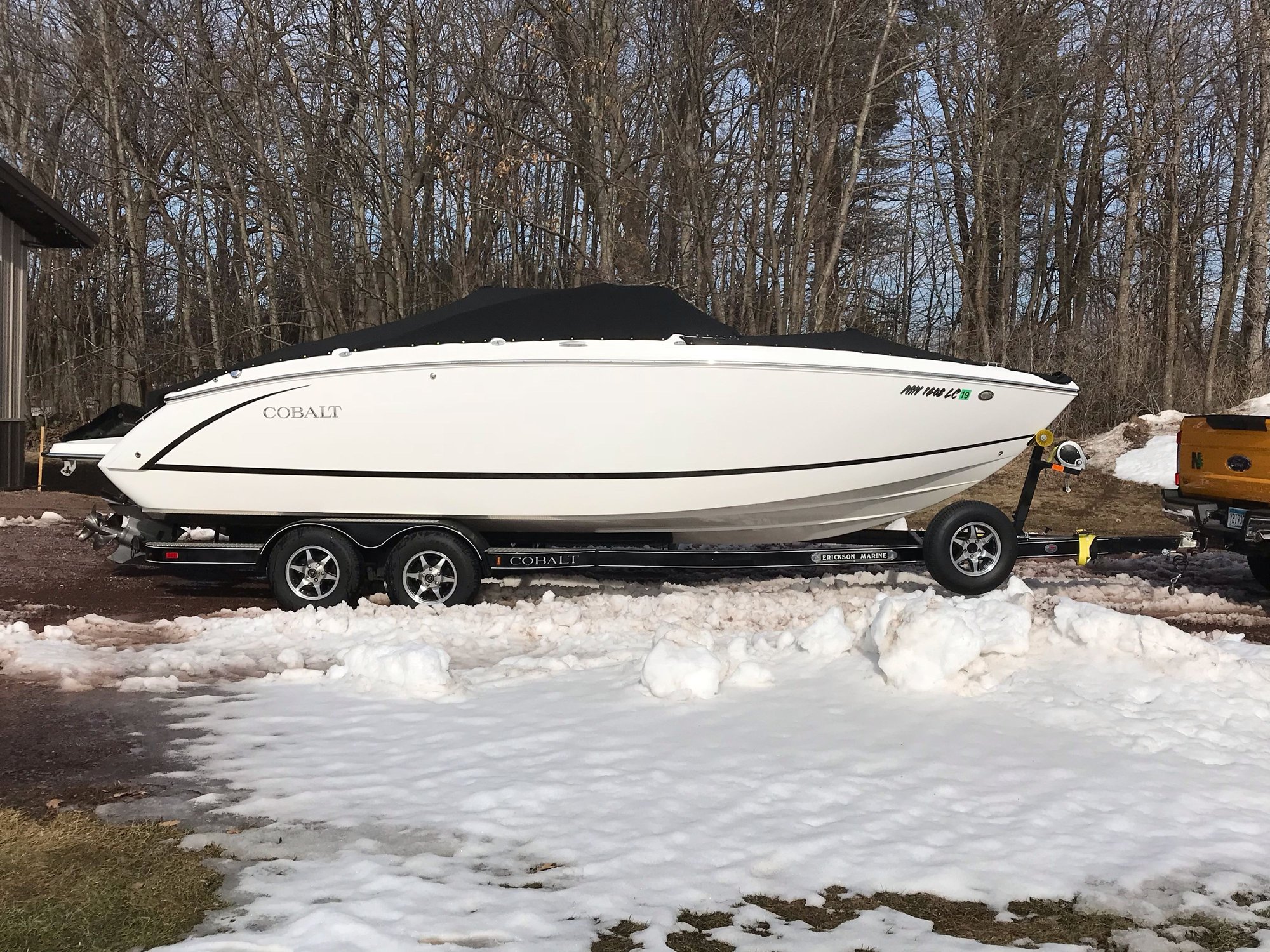

Like the posters above said, it’s really no different than driving on a salted road. But, if it is avoidable, why not avoid it?
I’m a fresh water boater, but I like my feet dry.
My last boat/trailer had my truck right into the water before the boat released from the bunks. I welded about three feet of extension onto the tongue, and my problems were solved. So if you do the same, your out of the salt.
When we ordered this boat, I had this custom trailer built extra long for the same reason. The rear tires just barely touch the water when loading/unloading.

Nice boat! We love ours!

The bigger/heavier the boat, the more depth it takes to float. Thus, the further you have to back in.
Our old boat was a 24’ Chaparral, and was sooooo much easier to handle than my current 27.5’ boat. The Chap took nothing to float..
