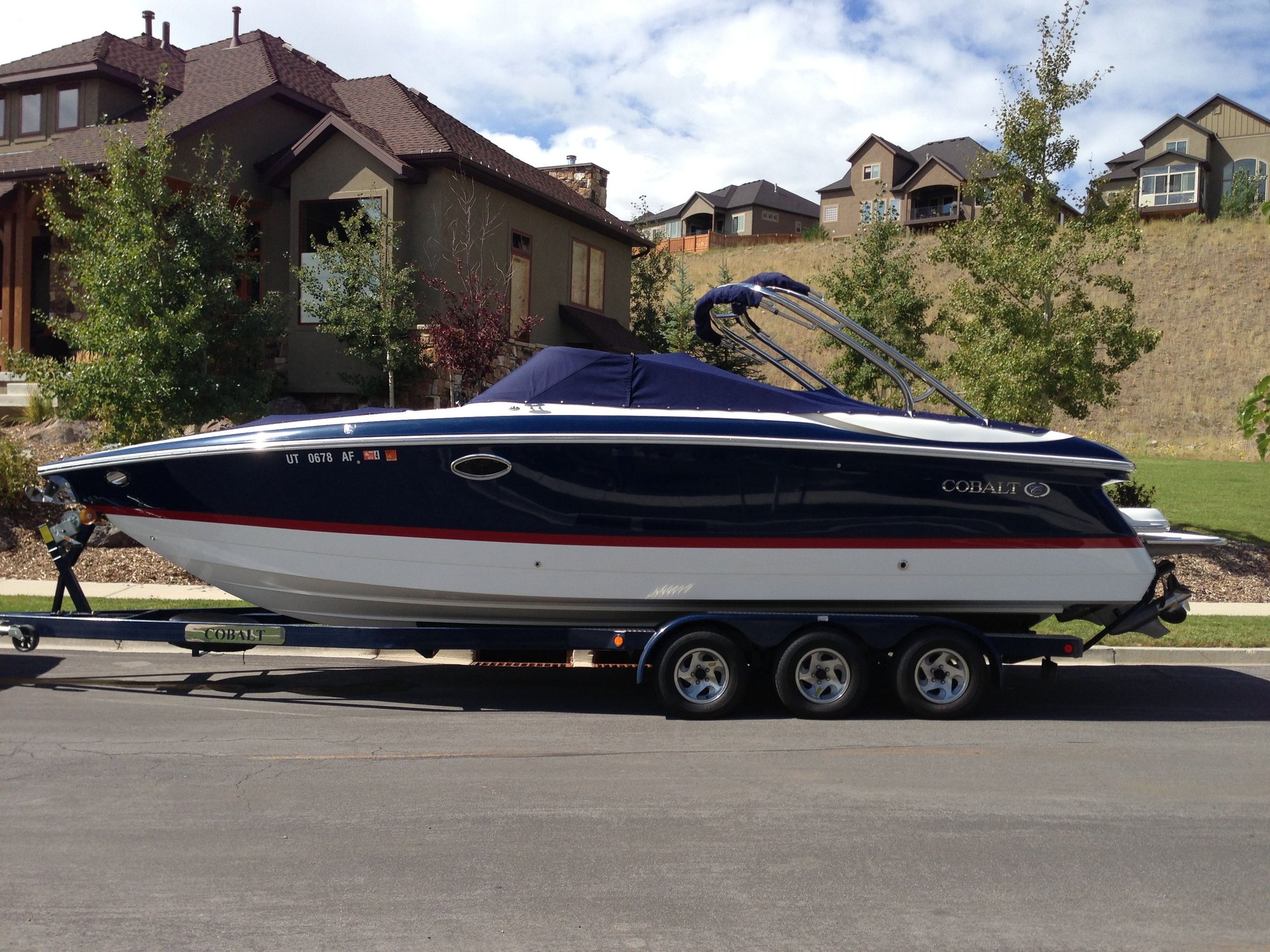

My last boat/trailer had my truck right into the water before the boat released from the bunks. I welded about three feet of extension onto the tongue, and my problems were solved. So if you do the same, your out of the salt.
When we ordered this boat, I had this custom trailer built extra long for the same reason. The rear tires just barely touch the water when loading/unloading.
Nice Cobalt, I miss my 282 and am looking for another!

Problem is my boat is 27’. So I have to get in up the hubs most times. I like the idea of welding on a tongue extension however it doesn’t need anymore length you know. See image on next post.
What about using a hitch extension between the truck and trailer? It could be installed in a couple of minutes in the dock parking lot, just prior to launching the boat.

Yes, every inch does count.
Not shown in the pic, but I use a solid ball mount that is an extra foot long, just to add to the total length.
