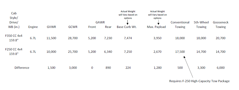

I did some studying to understand the differences in capabilities and payload between an F250 and F350 SRW because I just ordered an F350 for the same reason, we are going to get a 5th wheel. I believe after a certain weight / size 5th wheel, not sure the exact number, I would get a Dually. My truck will be a daily driver so we will shop for one thats not too big or exceeds weight ratings. I have attached a pic of a spreadsheet i did to help me understand. These are base weights and people and gear will deduct from payload (King Pin Weight).
I hope this helps.

and if you look at the tire ratings for those two trucks, you will probably see that the f250 rear tires are rated at 3200 max each and the f350 are rated at 3750 max each
