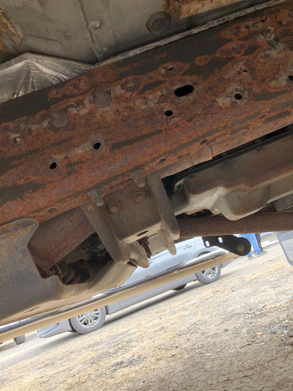

I was looking at this 2004 F250, it looks really clean...until I looked underneath. This is a truck for $13,000 that I’d be financing. It has the 6.0L Powerstroke. Should this frame have me worried? The rockers and everything else were very clean. It has 79,000 miles and I’m not looking to spend a ton of money in repairs. Thanks for any and all suggestions!

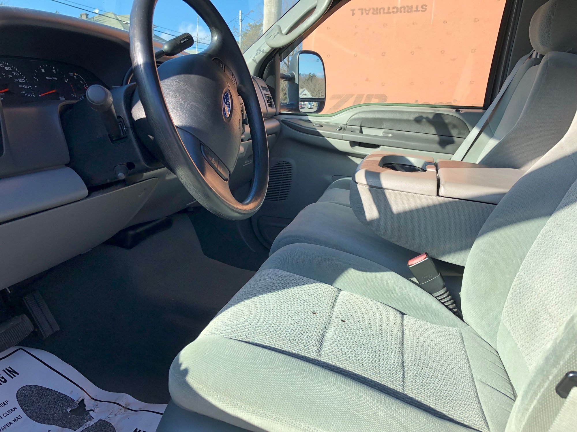

The suspension has me worried. Look at the tire wear on the front. You'll need to get that sorted and buy all new tires. The interior looks clean except for the cigarette burns.

as for frame photo... frames are very poorly painted.. no primer... so paint starts failing the first winter... same with suspension...

Personally I think the truck looks good and I would enjoy owning it. As noted, you might need ball joints or something in the front and you definitely need tires but those are rather small issues. I would take it to a reputable shop and have it checked out. As far as the frame, take it somewhere, have the underside soda blasted and then paint it and enjoy.

I would check that frame and make sure there aren't any places where its more than just surface oxidization. Rust is always worse than it looks, never better. If you do buy it, get something on that frame to protect it and prevent the problem from getting worse. I'm not saying you should buy it, but if you really want to, I'd be very careful. As others have said, the 6.0's can be massive money pits. As for the lift, the 4x4 etc. I like all that about it. Whether or not you need 4x4 or a lift, or diesel is sometimes besides the point. If you want it and can afford it, then by all means go for it.

A thorough, undercarriage inspection is in order before you jump to buy. I live in rust country so what I see in the pics would not necessarily scare me off. Undercarriages, inside door and body panels etc. can be oiled sprayed or chemically treated (Krown Rust Control or my favourite = Fluid Film). It'll make the dust stick to everything and accumulate making things look dirty and unkempt but those dirt layers are a good thing when defending against rust. The bigger issue for me would be ... what condition are the rest of the parts underneath. Things like brake lines, steering, brake and suspension components etc. That is where you'll pay the price for having unchecked corrosion.
