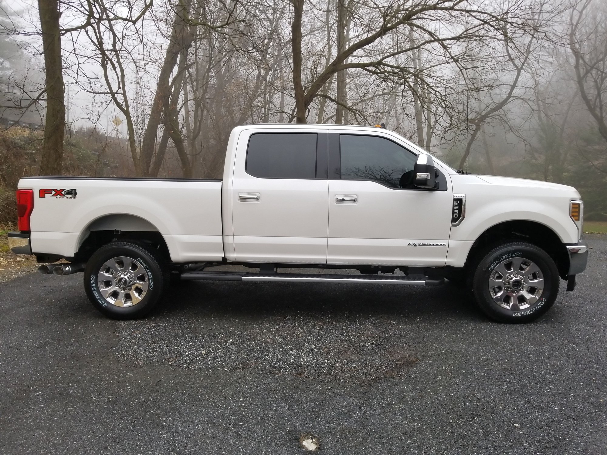

Snow plow prep here too. 3" difference as stated above.
Pic is right after i got it

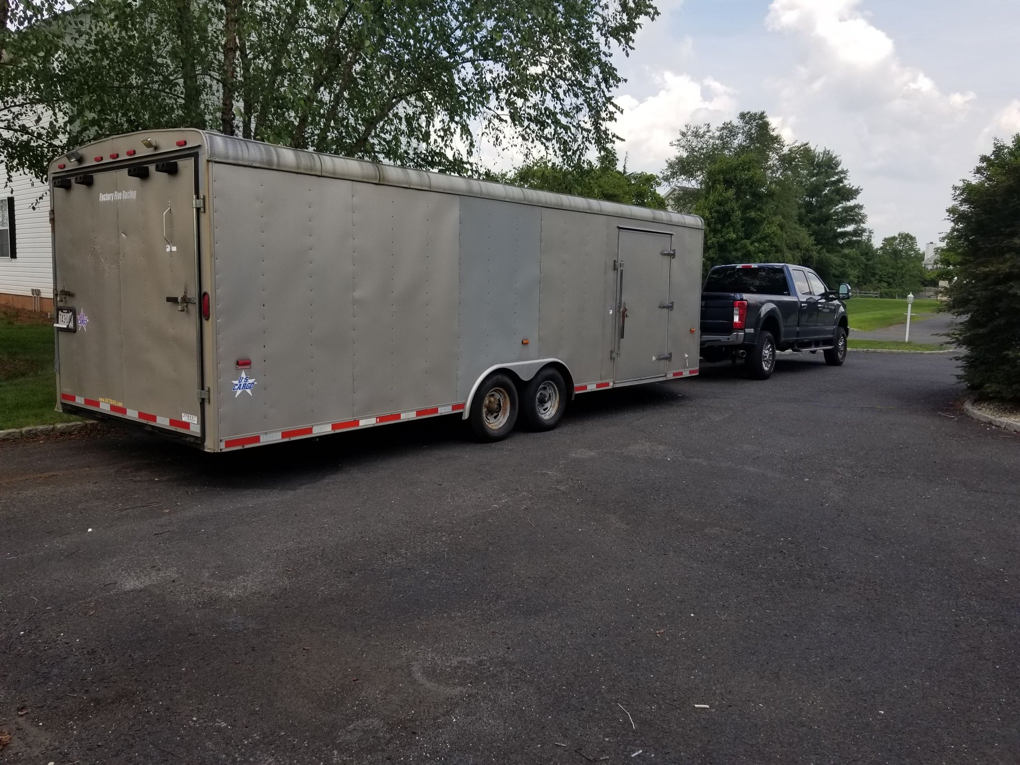

2018 F350 in my signature, 24 foot enclosed with equil-i-zer hitch. I have the plow prep but not the camper package.
With the 18 inch all terrain goodyears, it rides and tows like a dream. When I switched the hitch over from my 06 F250,
I had to invert the drawbar since the new F350 is about 3 inches higher in the tail than the F250 was. With the trailer
and my 11 Mustang inside, it's roughly 8500 pounds. With the weight bars on, it dropped the *** end about an inch.
Towed it from NJ to NC and back, hardly knew it was back there....
