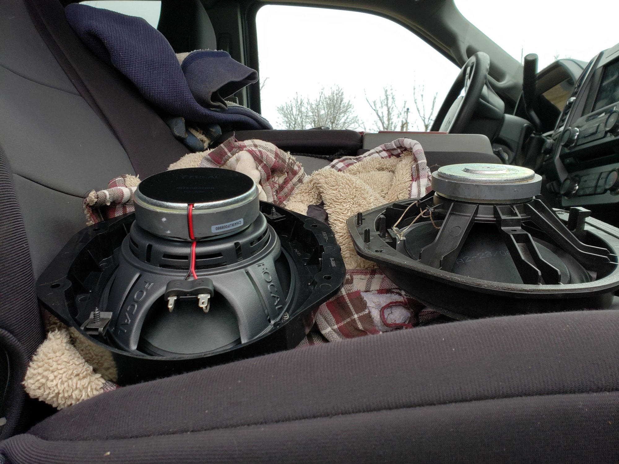

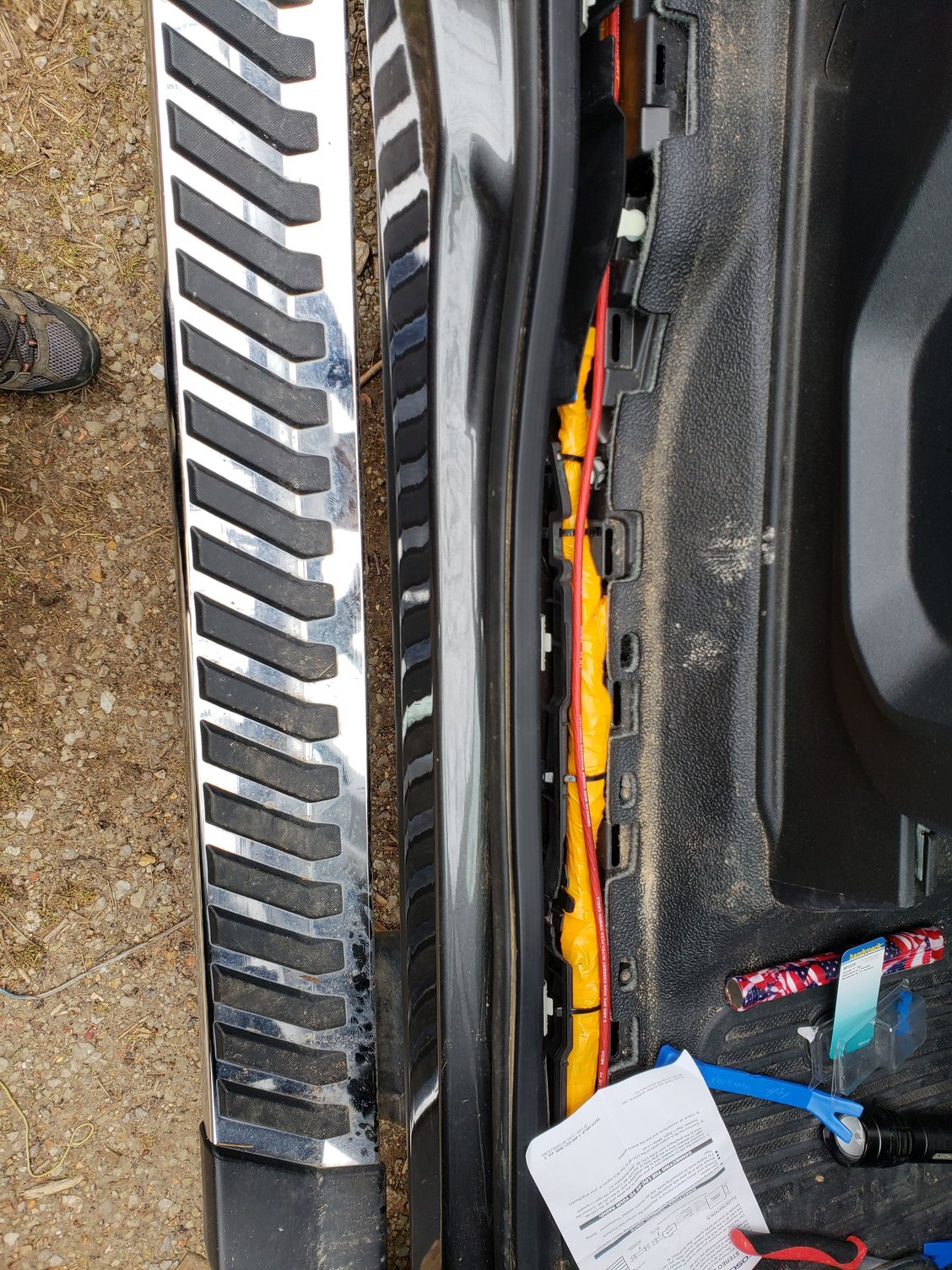

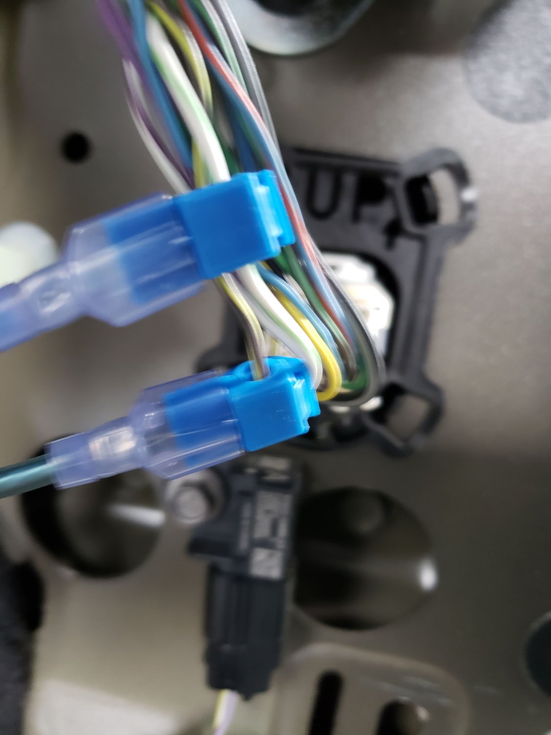

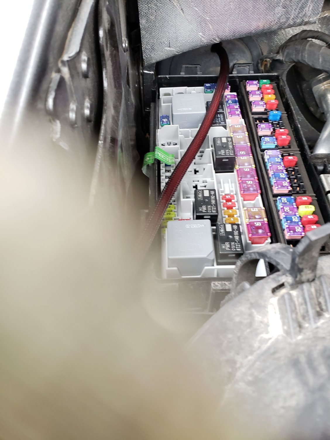

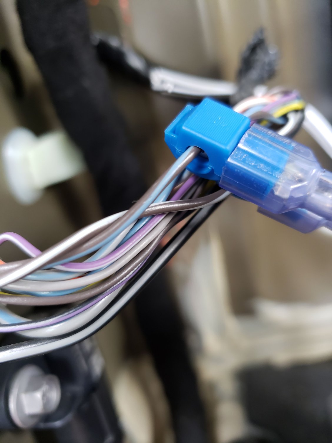

After reading many threads on here i decided to upgrade my factory stereo system. I am by no means a audiophile. First i swapped out my front speakers with Focal isc690s (due to crutchfield pricing) with a infinity reference 3.5 in the center. Loved the way it sounded with the mids and highs but lost all my bass. had i known what i know now i would have went with front 6x9 components and swapped tweeters. in order to restore my lost bass i added a jl audio micro sub enclosure with 2 8" subs with a 500x1jl amp. they fit after cutting my carpet back but its not a nice fit. very tight and maybe alittle overtight (i dented the the covers and decided to remove). I would have been happy with the single jl audio 8" 2 8" is overpowering for me and i have them turned down. that being said i tried to take valuble pictures along the way that may help someone else. here they are

Im a big jl fan. that being said the focals up front provide more then enough highs and mids. the c2 series is a 3 way 6x9 i believe. If i did it over again or was adding an amp to the door speakers in the first place i would have definitely went with components and tweeters (still may swap). I had to add an output line converter to run rca's to my amp. wasn't as bad as i imagined just had to tap into rear speakers(once you start tearing your new truck apart its not that hard to go alittle further). The jl box is 5ish inches top to bottom and is overly tight imo (took quite a bit of force to latch my rear seat) but it is latched. rockford has a couple boxes on the market that would probably fit better. As for your grommet question i assume you are talking about the firewall and it was the hardest part of the install. I did it myself but with a sharp knife and a coat hanger. Im happy to provide any feedback from my install you need. I wanted alittle more out of my sound system and ended up with way more then i need to make everything balance
