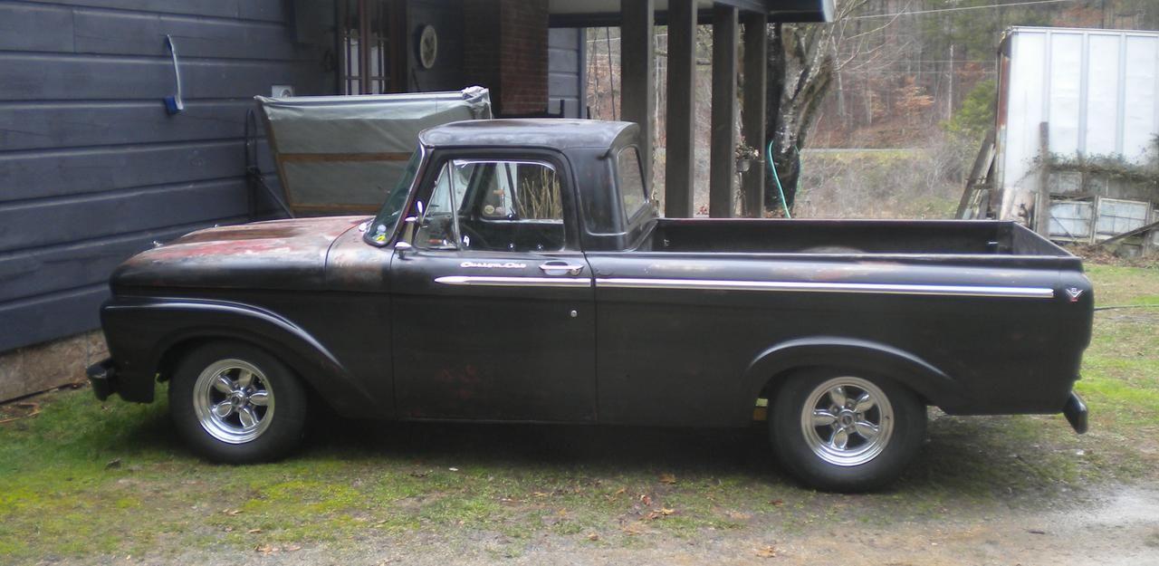

This is my 63, the only mods to the front axle is a reverse eye leaf main spring, and 2 leafs removed from the rear. Rides just like factory, Now, how did I get it this low? Simple!!! 2" body drop.....

I don't think I've ever heard of someone doing a body drop on trucks like these. How difficult was it?
