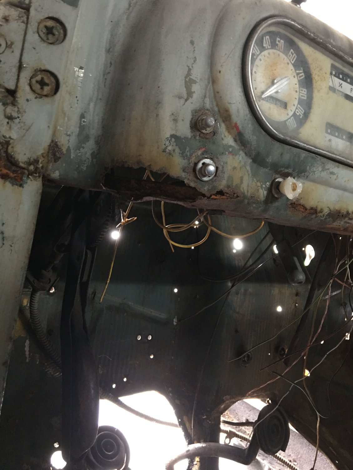

I have some strange area’s of rot at the bottom of my dash in the 48 F1. As it on the formed area’s it would be difficult to patch. I guess the screen was leaking or window left open for a long period.
does anyone have any experience of cutting in another dash panel or maybe an alternative that’s fit relatively well?
Thanks

It is unusual for the dash to be rotted. Perhaps someone with a junk cab could cut a piece out for you to weld in. A picture would help.

On one cab I had the bottom of glove box rotted out but it look like someone left some old flashlight battery's in it. Found an old cab that was useless and but out the part that I needed and it worked great.

I’ve found a dash from a 51 that while not original should be ok as I wanted to modify the center anyway

May have been caused by mouse nesting in that area..

I had one caused by spot light leak in that area I got another cab

I think if you have access to a English wheel you could make those pretty easy. Maybe not in one piece but very do able.

Unless you are doing a original restoration i dont see anything that would stop you from a nice dash extension curved piece added for a good looking
curved bottom.
That would be my guess.

I grafted a 1950 Ford Passenger car dash in place of the 51 f-1 dash and will be retrofitting an old lower extension from Classic Haulers.
Don't think that will solve the rot in your lower dash but will give you the opportunity to make a new lower dash.

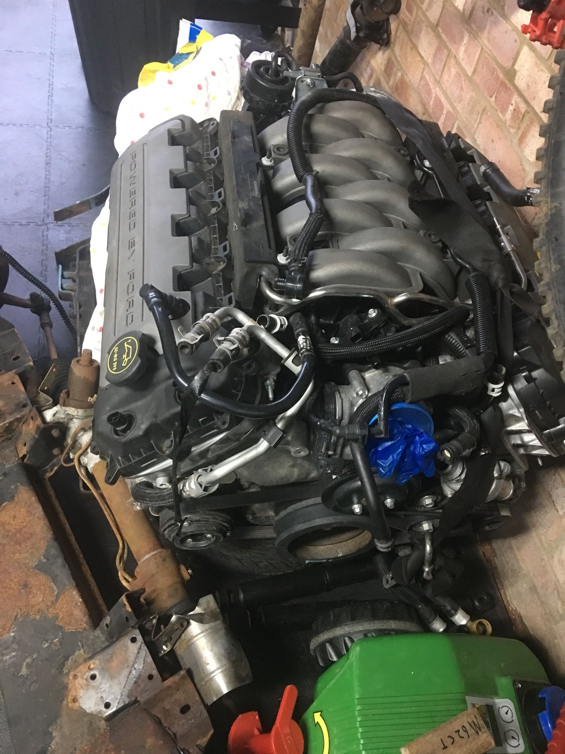

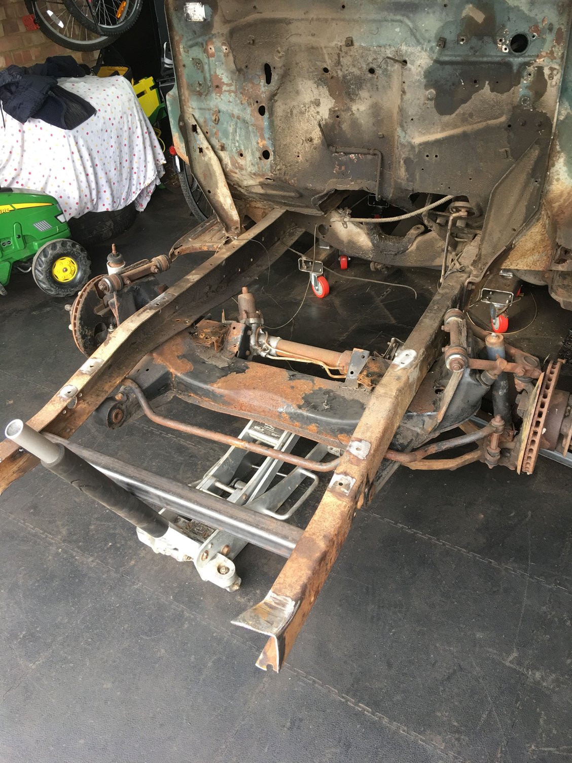

Here’s my truck, recently imported from Oregon. Typical farm truck on patch’s of rot but in good shape for 70 years old.
The plan is to fit the coyote below. Jag front, mustang 8.8 rear, air ride with 20’s and shine up the patina.
want her to be practical and fun.
im in Bedfordshire in the UK met a few US car people, no fellow F1 drivers/builders yet.
This is where I’m upto, test position. Going to start measuring up
