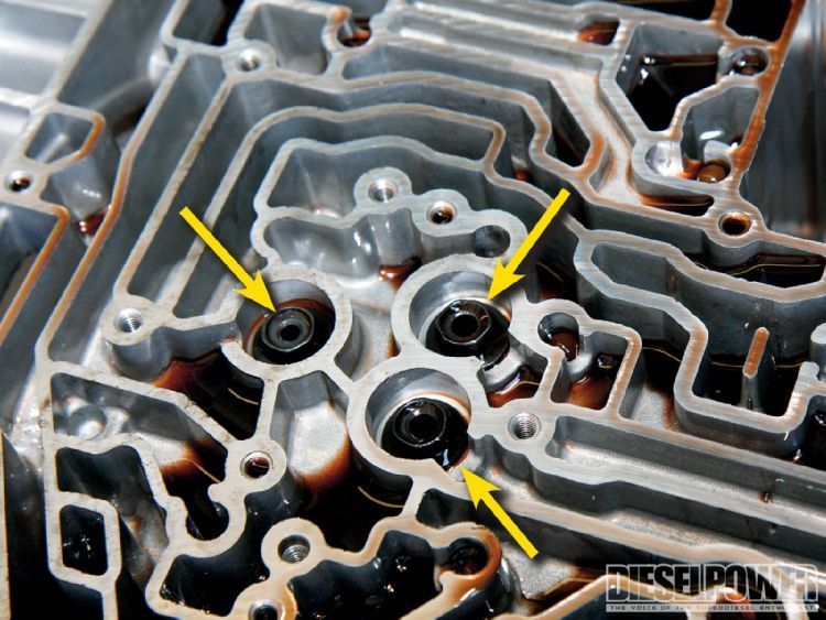

Its been me mentioned that the feed bolts under the valve body becaome loose, giving off your sympron...

So what is still be the feed bolts even though it works fine on jack stands even when I hold the brakes and increase throttle to break free and that works. It seems messing with the shift or possible vibrations or bumps are causing it to stop. Which I thought was a short but maybe those feed bolts do that. I am not against tearing it down but also can I check the feed bolts with the tranny in the truck? or should I pull it?

The feedbolts can be checked with the trans in the truck. Take off the pan and the valve body and the feedbolts will be accessible.
There is no short that can cause a neutral condition. It has to be something mechanical. Everything works on jackstands because there is no load. When the feedbolts are loose and leaking pressure there is minimal pressure to hold the clutches. With the tires in the air you need almost no pressure on the clutch to hold it. It's a different ballgame when the tires are trying to move the truck. That takes quite a bit of pressure to keep the clutches from slipping.

I ordered a rebuild kits with gasket and seals. So I'll tear down the to the valve body this afternoon and check the those bolts torque specs. Anything else I should look for while I am down there?

Either those are loose or it needs a rebuild.
