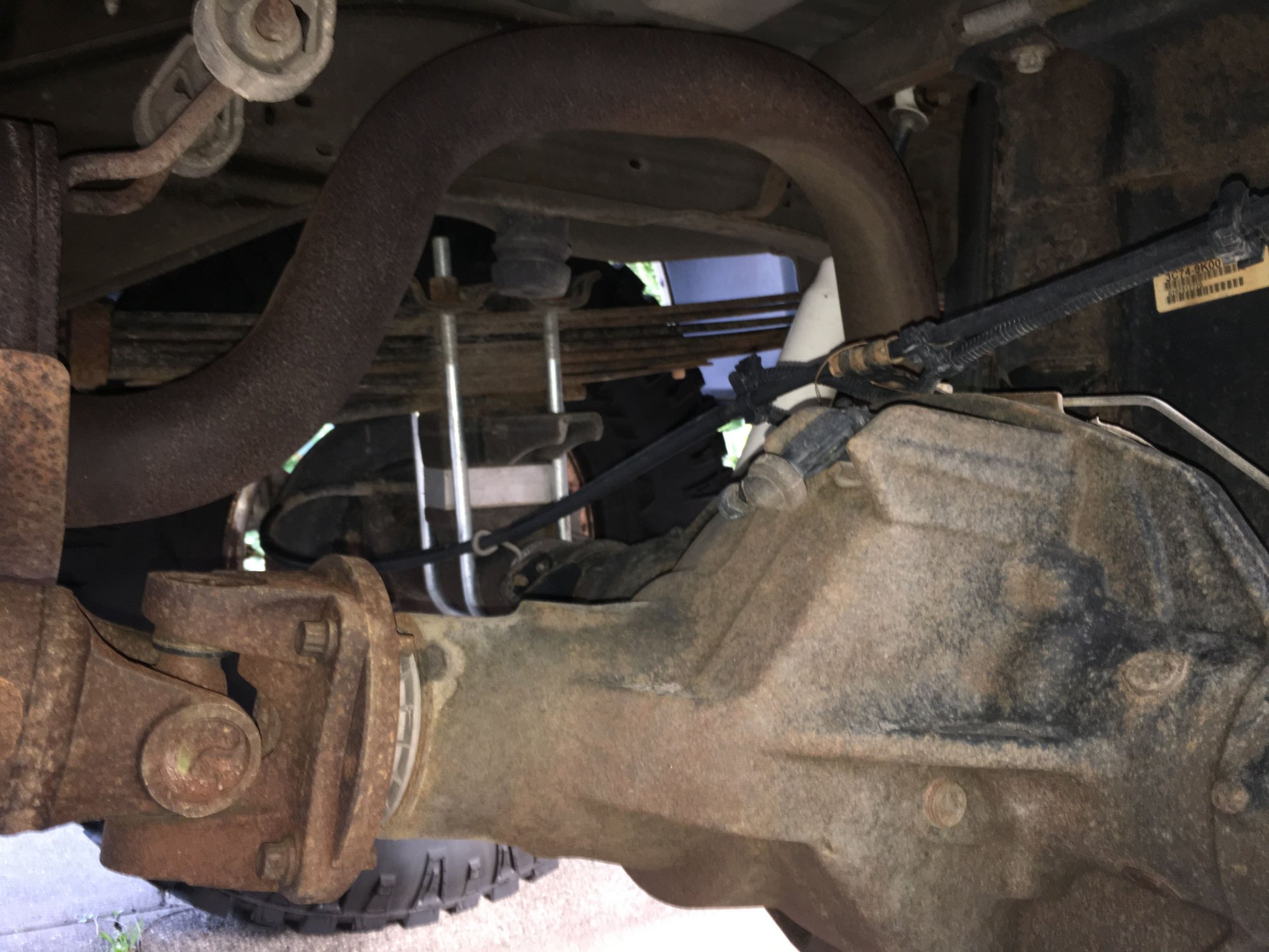

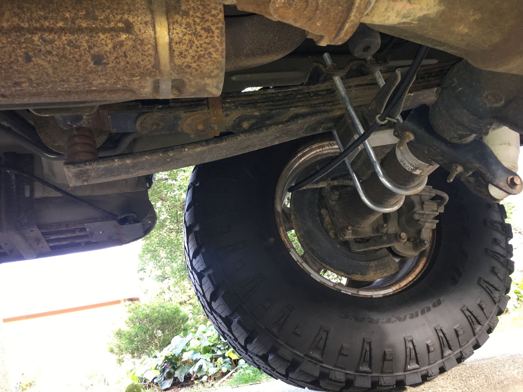

I see no evidence of suspension work beyond the lift kit in the paperwork. So maybe it could use new springs? Here are a few photos. Let me know if there is something else you’d like a look at.

Back to your current setup, yes the rear spring looks to be stock, however a better pic is required so I can see more of the rear spring, trying a pic from the driveline looking out and from the axle forward all the way to the spring hanger.

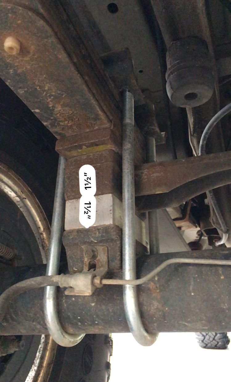

while you are under there can you measure the aluminum block and the factory block. It appear your rear lift is provided by the addition of the silver colored block

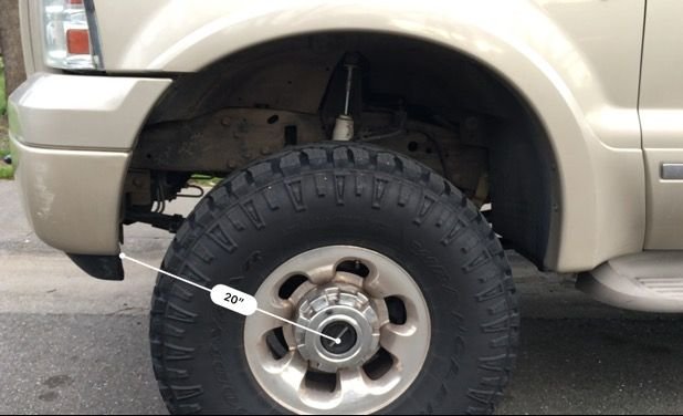

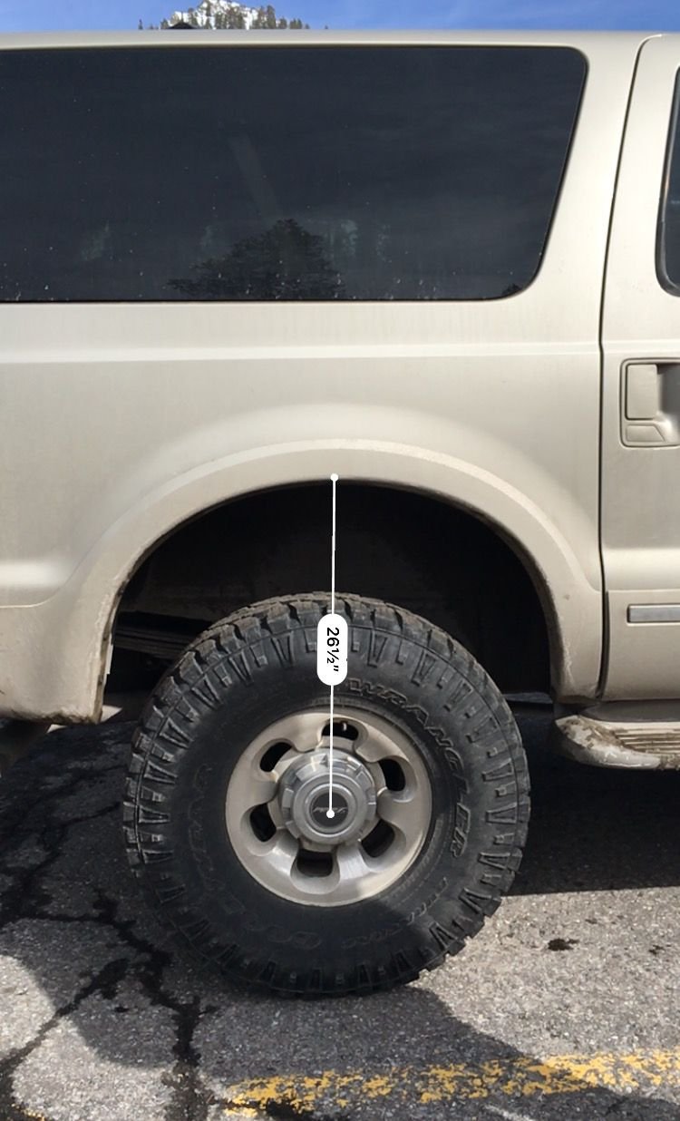

also, we need the measurments from the center of your hub to the bottom of the fender lip both from and rear.

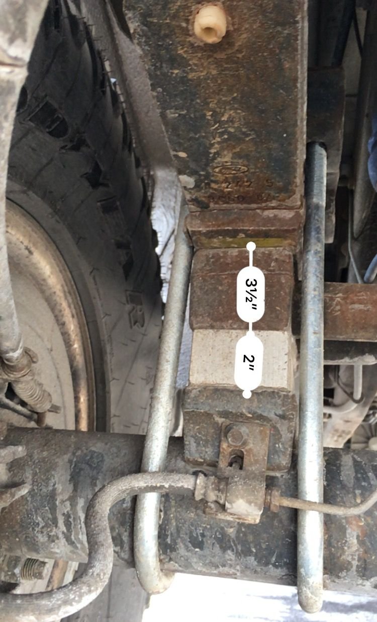

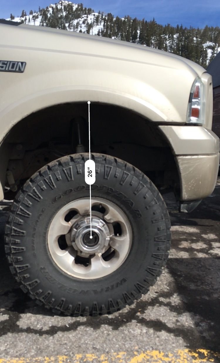

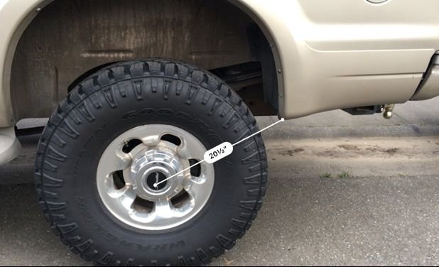

Im back in town with the Ex in daylight and got some more photos & measurements. I haven’t had the chance to push the front wheel yet.

Your measurements are off, at least the stock block. It’s not 1 1/2”.
When measuring the center to fender measure vertically.

1. I see somebody added an additional leaf to the rear spring pack, looks like an “add a leaf” which makes it worse because not only does add to much springs rate they have more arch then your other springs, that binds the leafs above and below it causing additional friction which prevent the suspension from articulating. All in all a poor setup for handeling and ride quality.
2. As mentioned, Measure vertically to the bottom of the fender arch, or to the bottom of the hugest point in the fender opening.
3. Double check the block measurment... I am not aware of any factory block that is 1.5” the end points of the red line is point to measure

Alright. I think I screwed up all the measurements. Here’s another try.

Your front is lifted 3” but I can not confirm those are procomp springs from the pic, however your leaf found suggest they are are at least the approx correct spring rate and they look to be in good working order.
the back is lifted a total 2.5” 2” is from the aluminum block and 1/2” is from the add a leaf on a stock rear spring pack.
The stock Ex rear suspension was less then ideal to begin with and these mods made it worse. I would change it if it were mine. however this is not the root cause of your poor handeling.
your wander is almost certainly from your current alignment setup. See my post #24 above for the fix.
