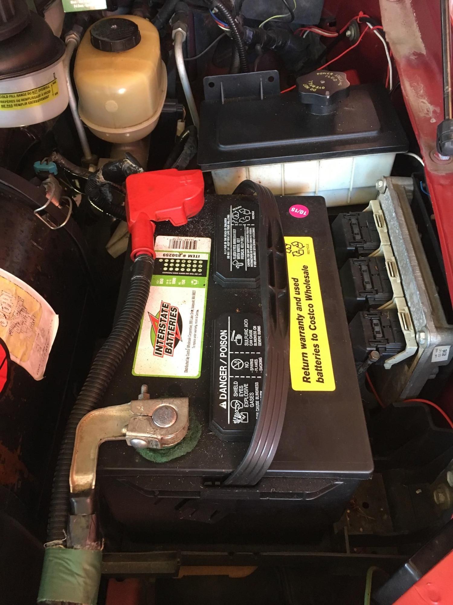

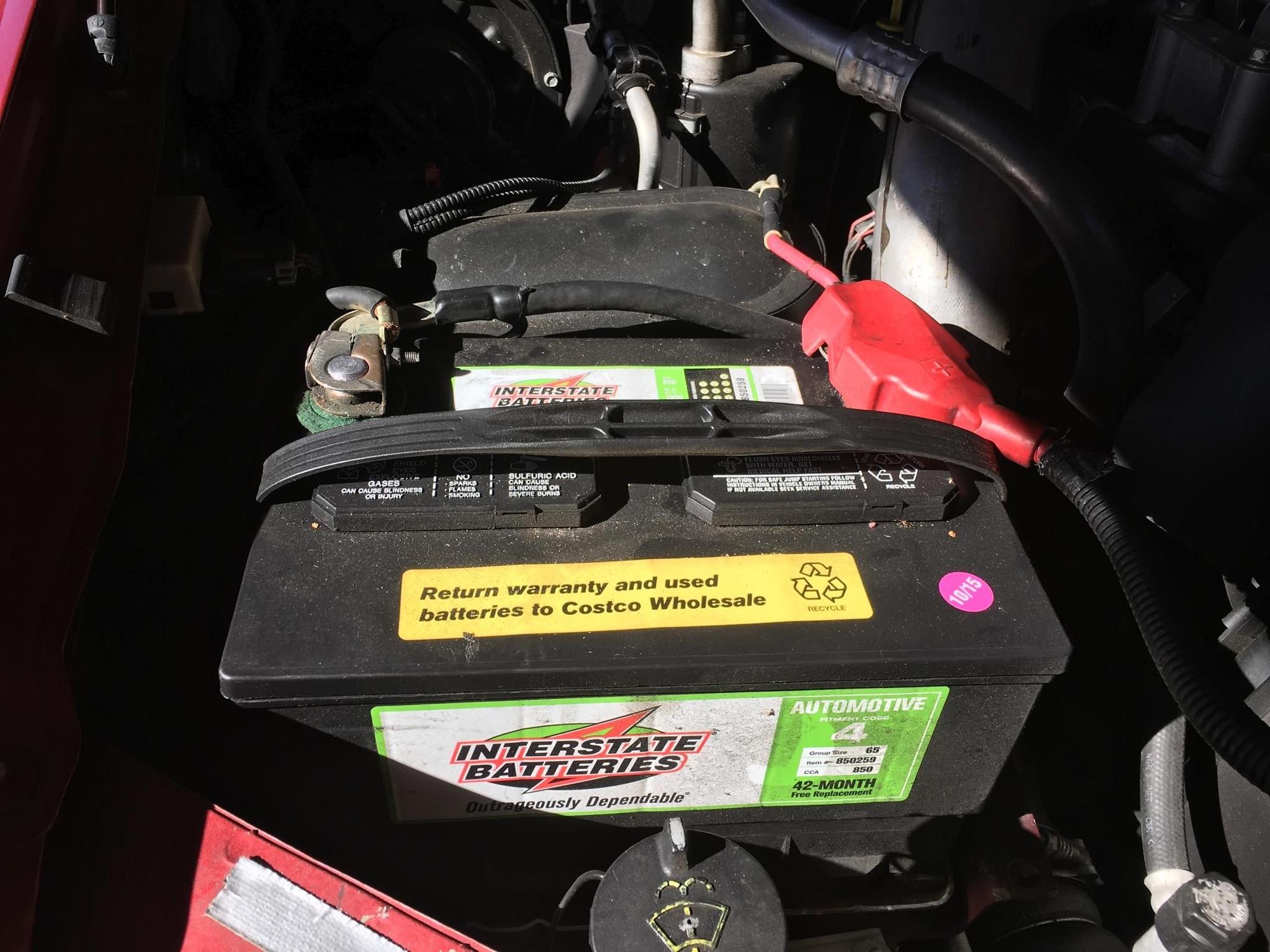

Also pictures of the top of the batteries to show the connections would help.

Thank You. I will have him take some battery top pictures. Tomorrow i am having him swap out the batteries for the batteries that are in my 7.3L. They are new and I know they are fully charged.

Pictures

So today I had him put my batteries in his truck. My batteries were also only at around 12.2v. He turned it to accessory only and the injectors buzzed. Tomorrow he is going to Costco to get new betteries and we will see what happens? Is it possible the batteries are so bad that it wont even let the scanner be recognized but the lights will work on the dash?
