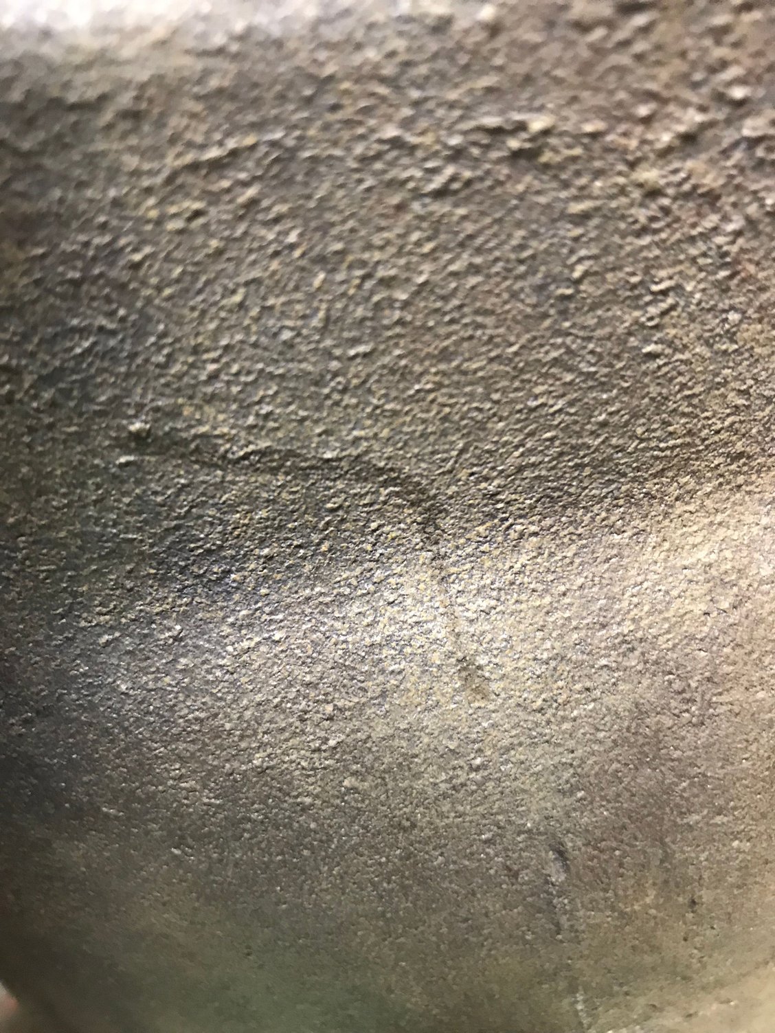

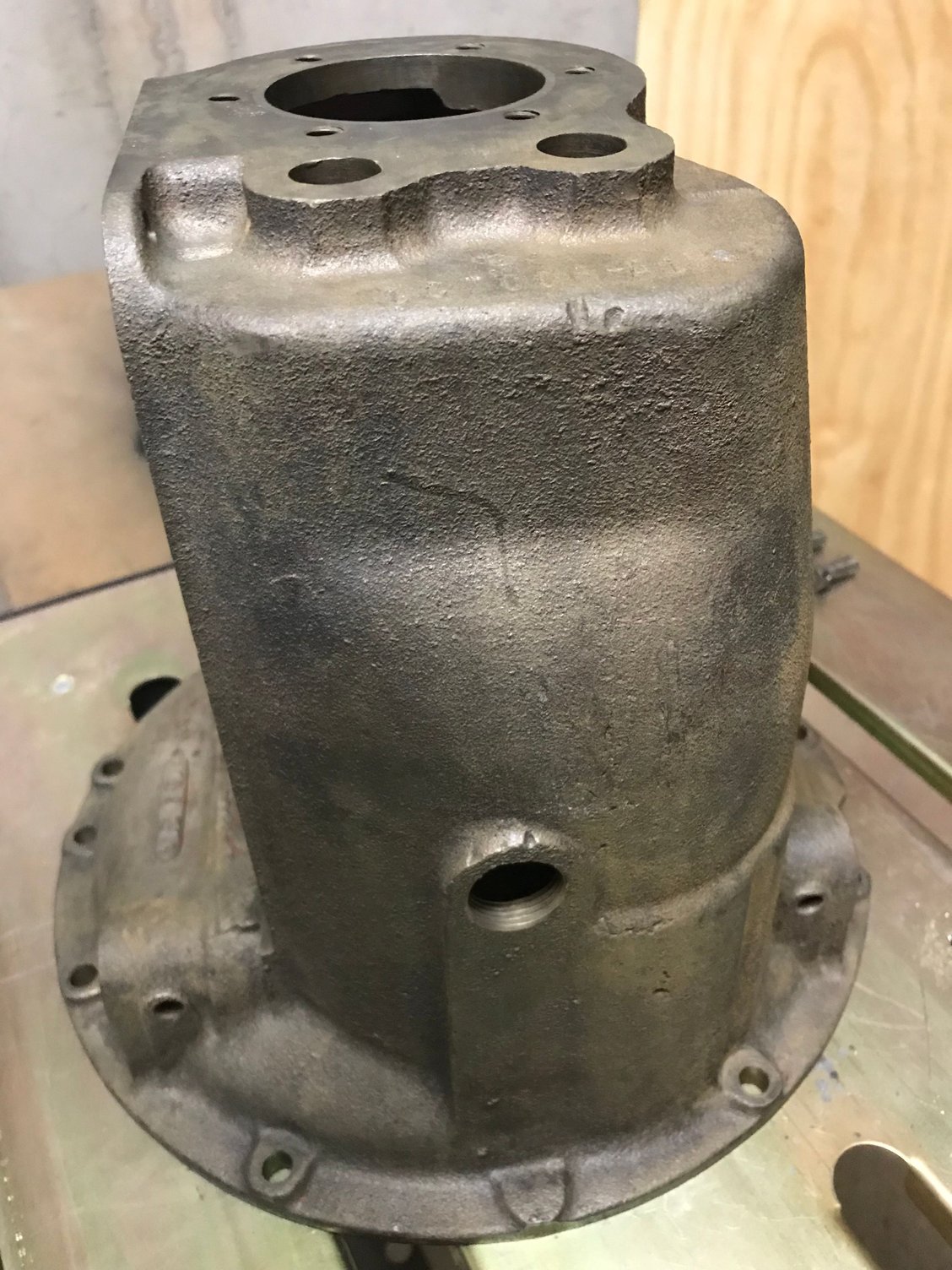

The transmission cleaned up well with citrus desolv. I soda blasted the case and rinsed it in a hot water bath and dried it with compressed air. Glad I did that because I found what I believe is a hairline crack in the bottom of the case where the idler gear support is. The dark spot cleaned off with lacquer thinner but it makes me think gear oil seeped into the crack. I guess I need to have it magnafluxed to be sure. Any test I can do at home to determine if it’s cracked?

That does not look like an area where a crack would form, IMO. It does however, look like an area that has a problem. Ford and other manufacturers had casting porosity problems around this time period. The porosity problem is the reasons you see so many of these old castings coated with red oxide paint. Some castings had this coating inside and outside. Ford tractor castings and some nine inch Ford rear end castings come to mind right now. Some light duty transmission cases got the red oxide treatment as well. A friend who was a Ford Tractor factory field rep back in the 1950s relayed this information to me.
Edit: Gasoline would seep thru any defect in the casting rather quickly.

The inside of the case has been painted red, I am assuming with glyptal. It’s almost like a casting flaw both on the inside and outside. The only thing that worries me about it was that it’s where the idler support is. Makes me think either a fatigue crack or a loading crack due to a chipped tooth etc? You would think though that the support would have cracked around the idler shaft hole and not the case if it was a metal fragment strain. I have glytal paint, should I paint it and run it? The case is in great condition otherwise.

I put the bottom plug in and filled with a little kerosene. It’s a crack, as it seeped. Guess I will be looking for another case.
