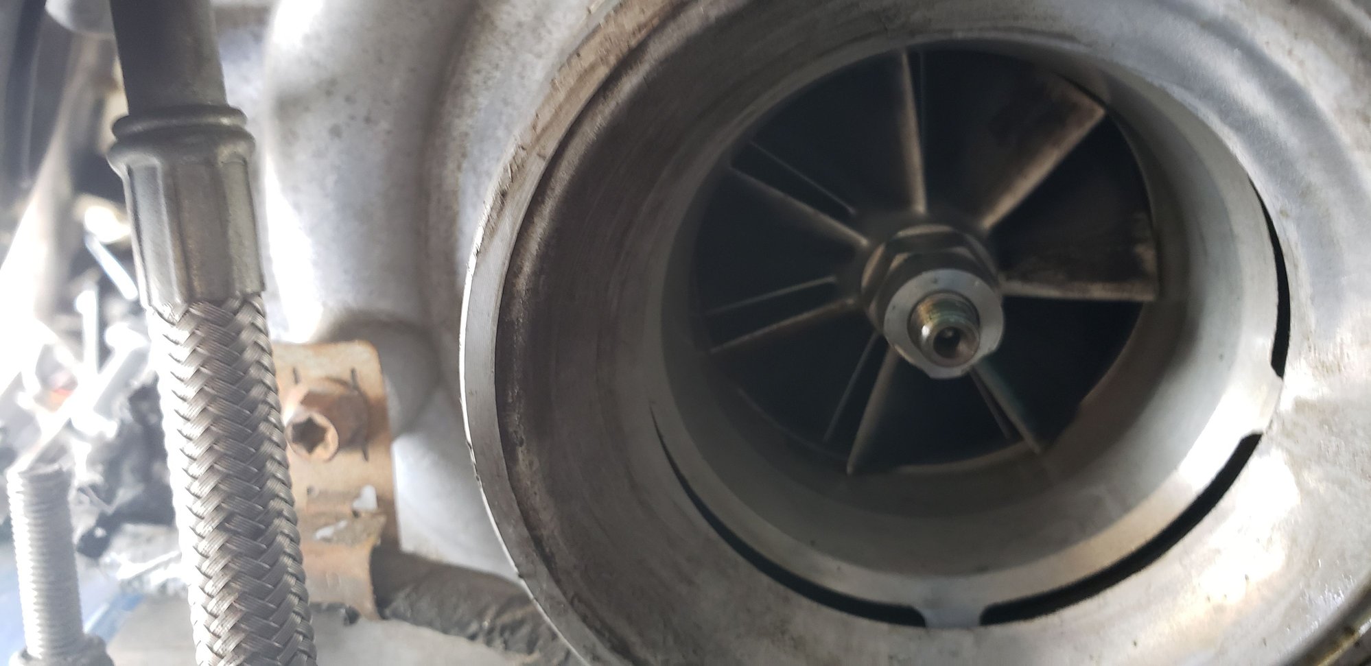

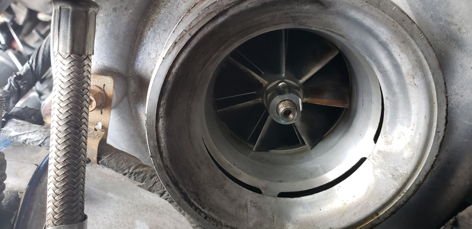

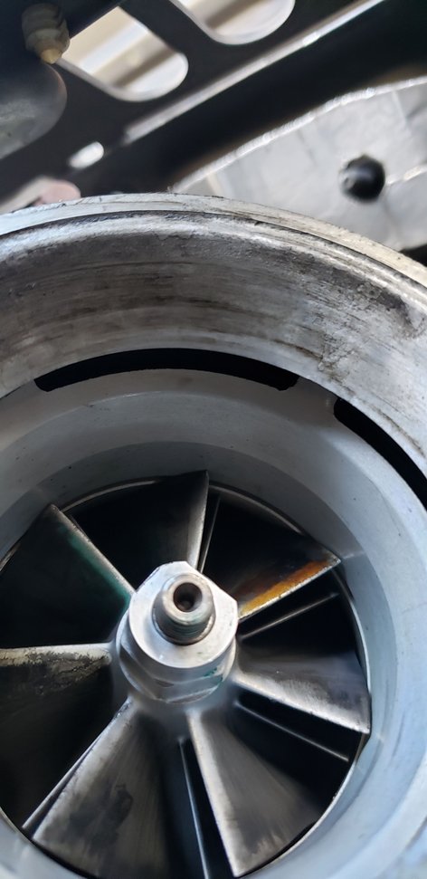

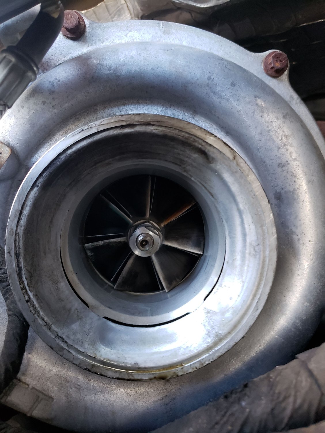

I will at least try it. There is no movement back and forth on the shaft but a tiny bit of play up and down. No sign of the fins rubbing on the sides. I am leaning towards a cleanup but the turbo has 100,000 miles on it. Here are some photos.

I think hooking that crankcase breather back up 6 months ago has gummed the vanes up. I had it bypassed for 5 years. I noticed 2 tiny pieces of what seemed to be leafy plant material stuck in the oily film inside of the intake hose that connects to the turbo.

Any thoughts on how the fins look ?

I would clean it up with some sort of cleaner, then see what it looks like. From the glance, it doesn't look very good.
