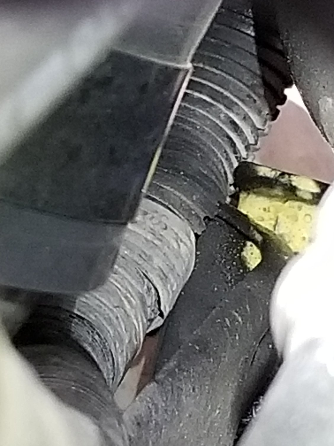

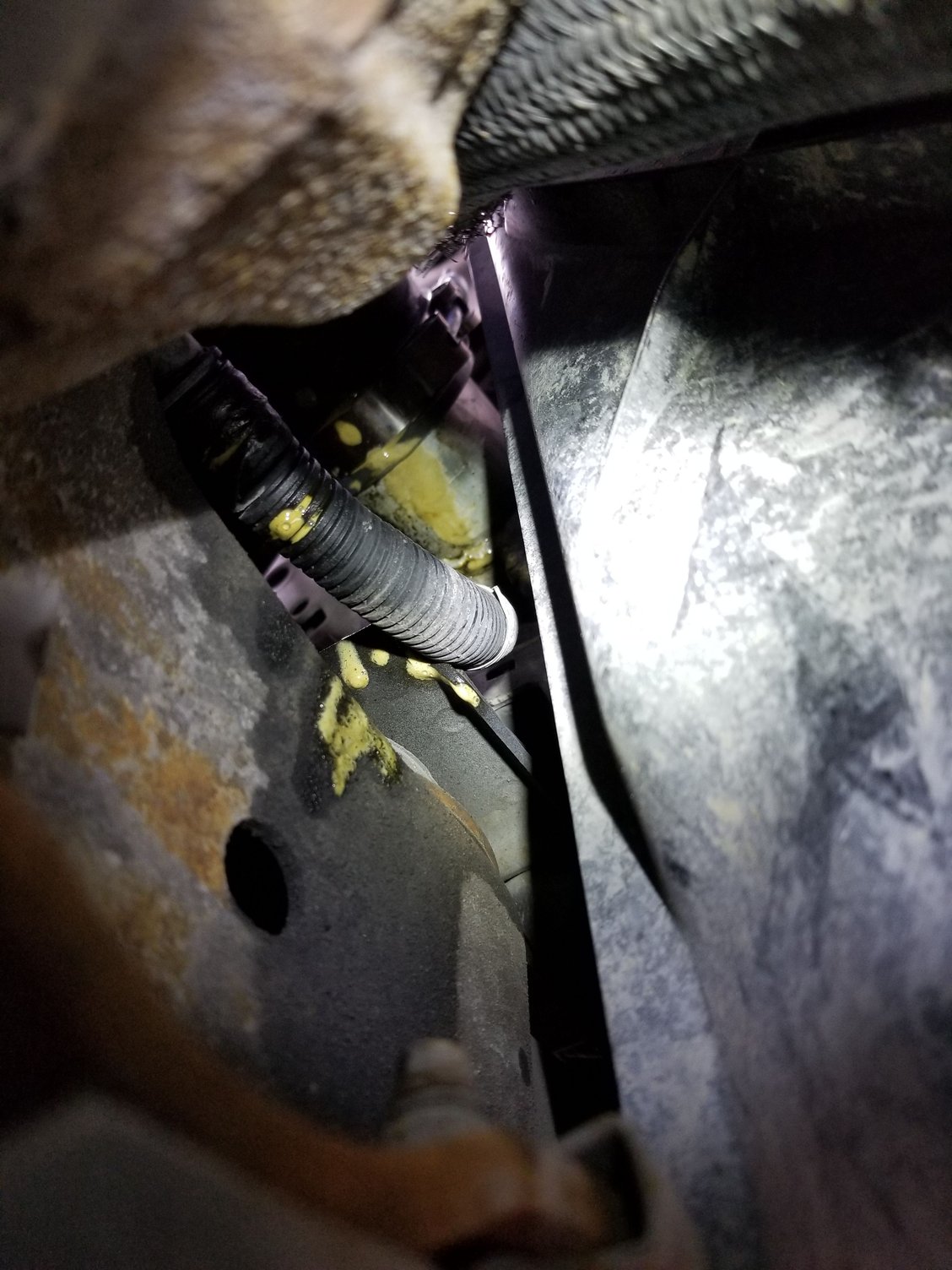

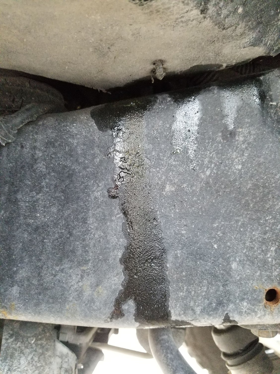

On a 45 min interstate drive hauling the boat I noticed the boost was hovering around 17 to 20 psi relatively flat ground. We get to the dealership and found a trail of oil on te driver side.
Got home to do some further inspection.
Oil puddle to the left side of the pic.
When I installed the metal pipe I torqued the clamps to Ford's spec. Perhaps it needed a little more. We'll see what torque will show now. Probably should have pull the boots off the and cleaned them.
