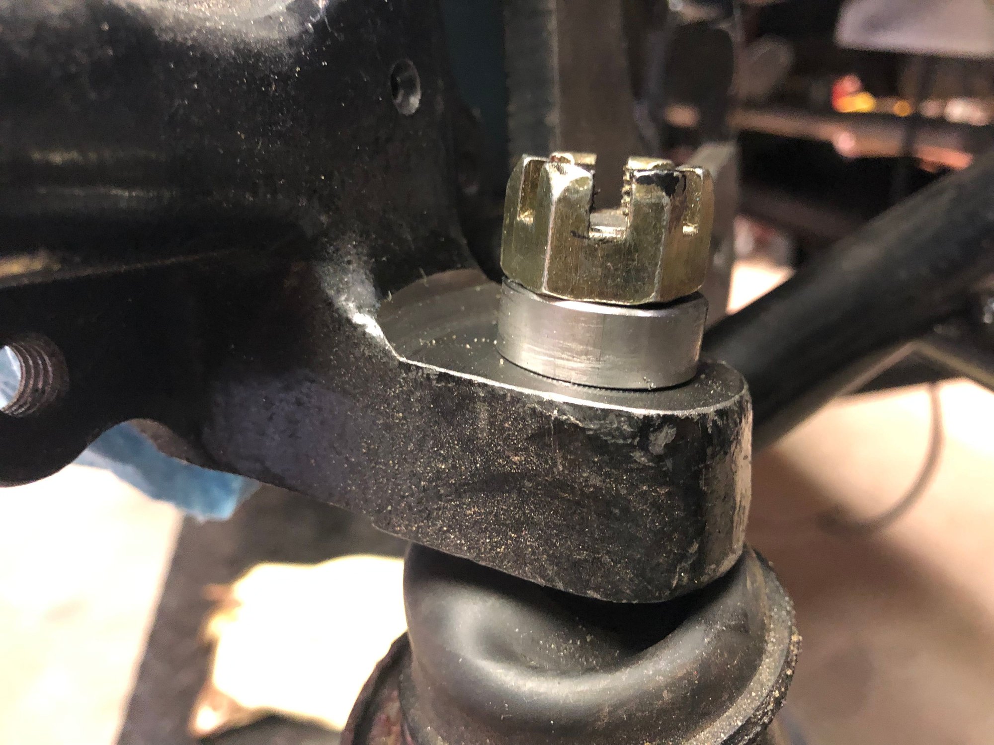

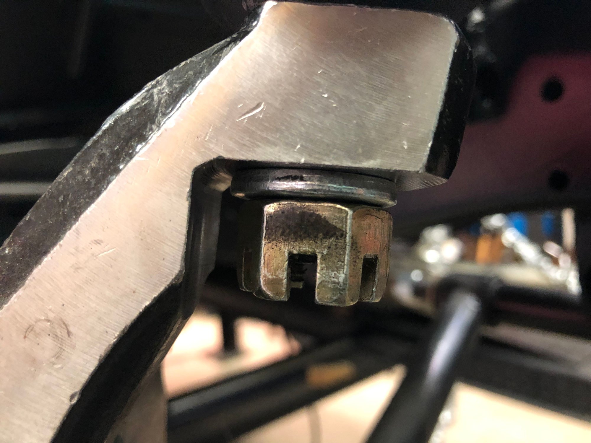

John I bought my suspension from Jim Weimar also and have a question. I don’t remember the washers on the ball joints/a-arms form the last truck years ago . Can you or others tell me if I have the washers in the correct position I think I do since the taper needs to fit tight.

You have to be able to put a cotter pin through the castle nut so you don't loose the nut. It don't look like that is going happen in those pictures..

John I don't have anything tightened up yet I just put them together for the photo and to see if that is correct for the placement of the washers. Once I get them tight I will have the cotter hole showing. So is that the correct placement for the them.

I'll have to go out and check mine but you'll know for sure once you tighten them up. I didn't realize yours weren't tightened in those pics..

thick washer on the bottom
skinny washer on the top
