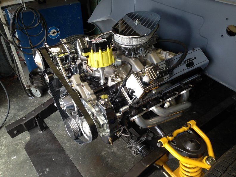

Up till now I've only backed the truck in and out of the garage in a straight line. Had it running today and thought about testing the power steering. As I tried to turn the wheels it would turn easy a half a turn then sorta bind up, I could turn past it and it was easy, then another bind.
ran out of time and couldn't trouble shoot this p.m. So I'm wondering what to look for. I'll add that the front end has not been aligned and I know it's no where near right. Could that cause it ?? Just brainstorming tonite and thinking about problems... It's a MII rack with tubular control arms and a CVF front belt system with Saginaw ps pump with the pressure reducing valve installed...
fluids check ok and the rack is new... Might try tomorrow to jack the front off the ground and try it to see if the bind is still there... it should turn with one finger, right ???
thoughts ??

I would first jack it up and turn it without it running to verify smooth movement of all components .I would also assume your pic is pre run as it looks like the belt should be on the other side of the idler just under the AC pump . If you have insufficient belt tension it would cause your problems IMHO

thanks bear... the picture is pre run. I was waiting on a turnbuckle to come in before I tightened everything up..
