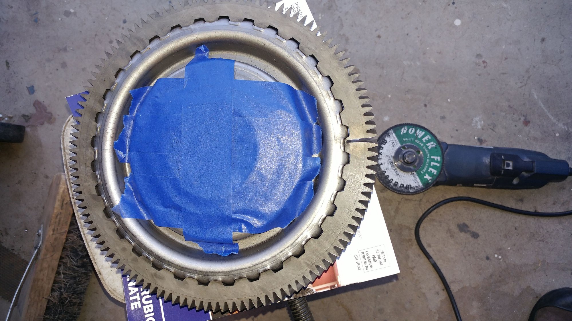

So I'm getting back to my 4r100 build project from last year. Its a 2002 4R100 for a 7.3 4X4.
Here is my question, can I uses a PTO coast clutch in a non PTO trans without any other mods?
That would give me 50% more friction material without spending $360 for the modified coast clutch.
What other mods should I be looking at as well?
