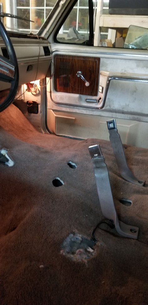

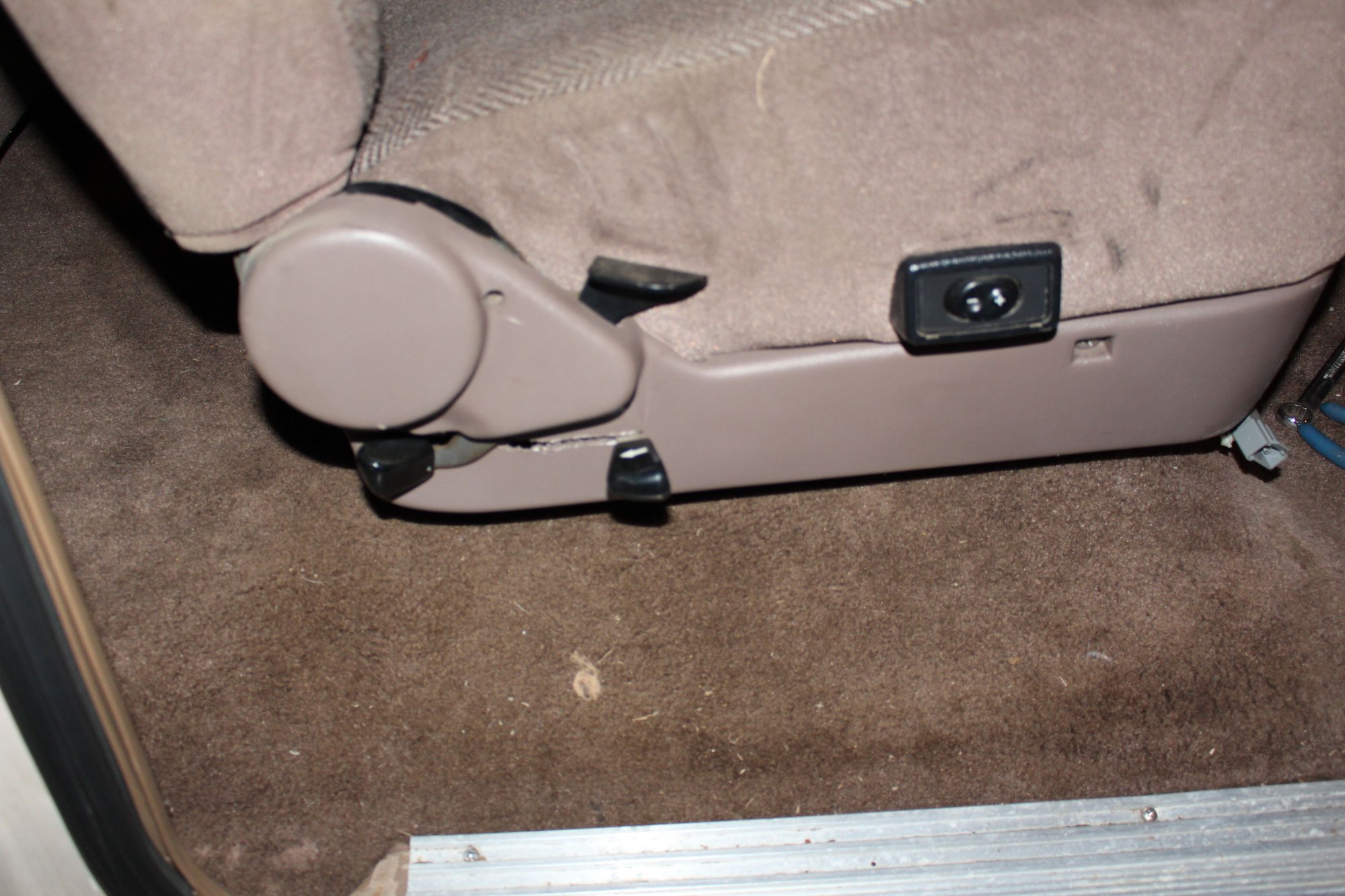

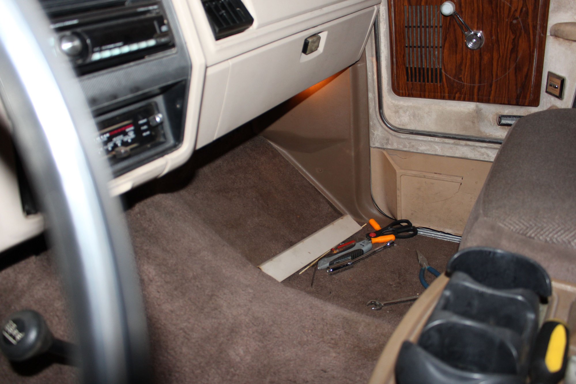

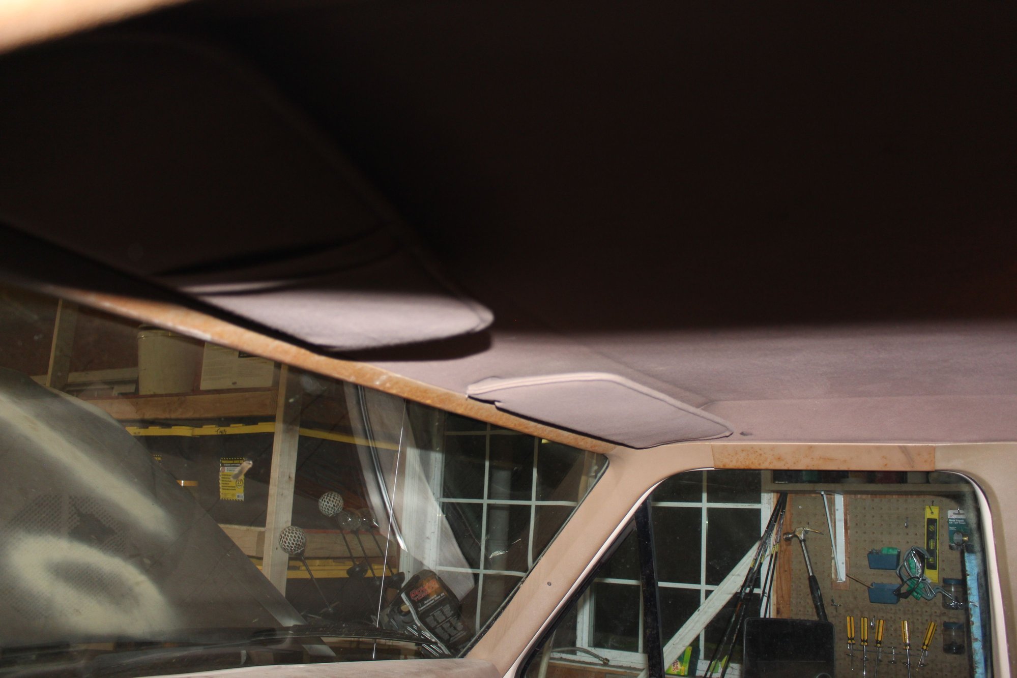

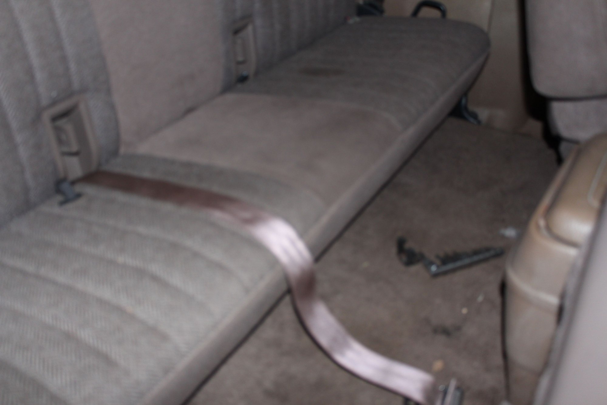

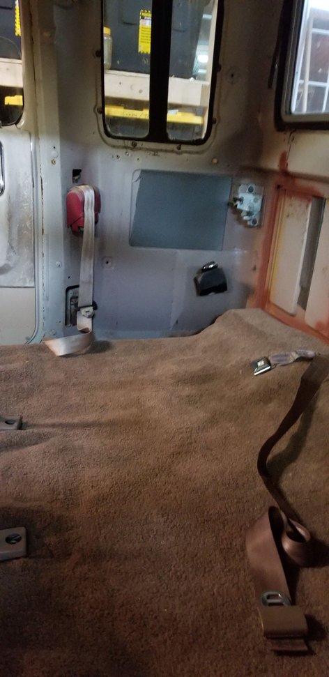

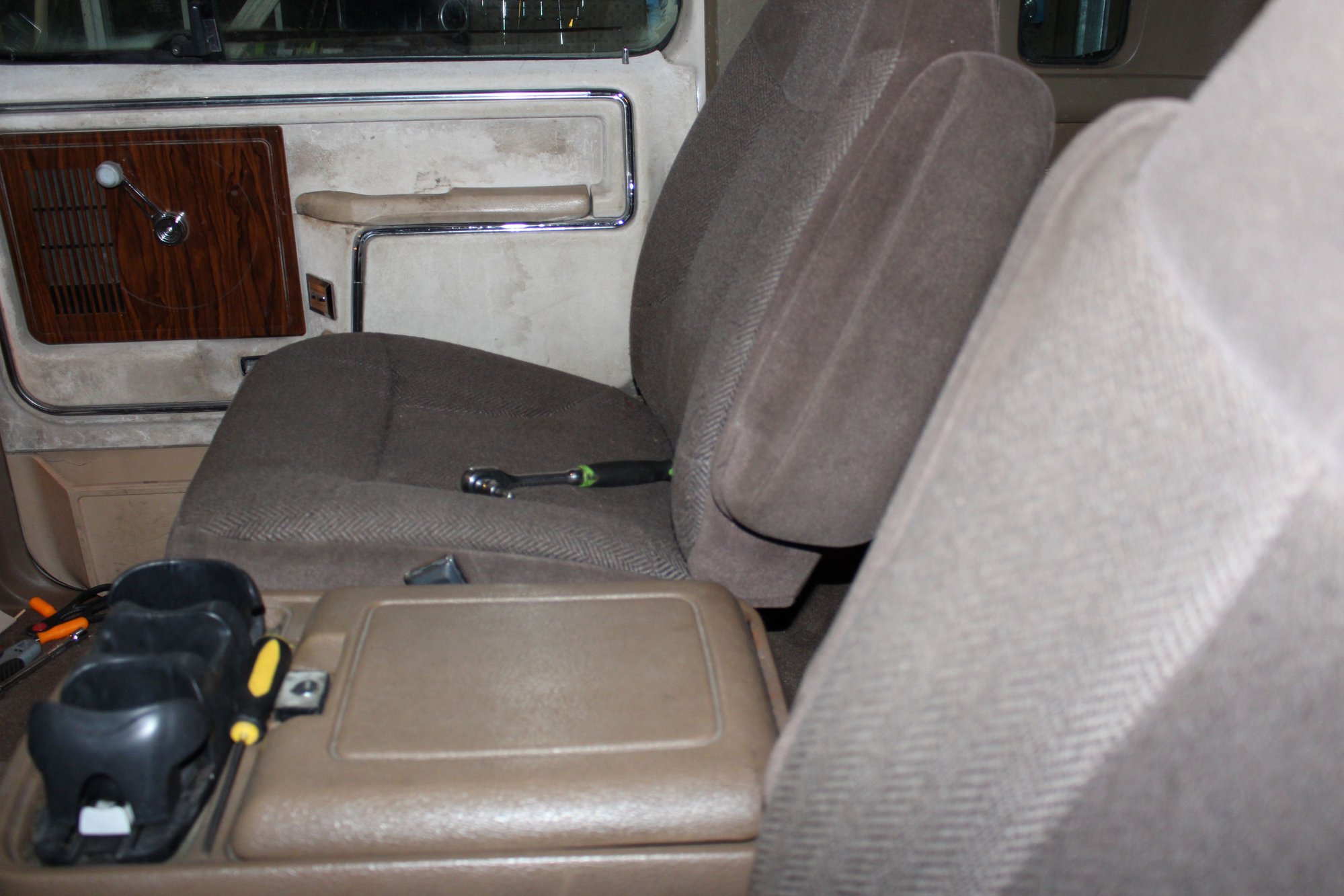

Thought I should update this a bit, Interior is all in and I am super happy with it.
I took the carpet, seats and headliner our of the 92, I had to find a bullnose in the Junkyard with capt chairs and steal the bases. even with that it was a tiny bit of fab to get the new seats on old bases. (had to drill a couple holes but not really bad at all. I also had to melt a hold in the plastic for the seat popper. Its all dirty from putting the panels back in so it needs a vacuum but other than some surface rust on some of the metal trim pieces its pretty good.
I decided to take the fuel tank filler tubes from the 92 as I am missing gas caps and I have the rear tank out anyway
