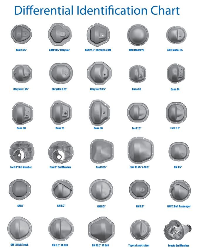

easy way, fill plug = Dana

Originally Posted by Sam I Am
I think that's for passenger cars, my tag is totally different. But thanks for the reply.
It should have 2 tags on it, see my edit in the previous post.
