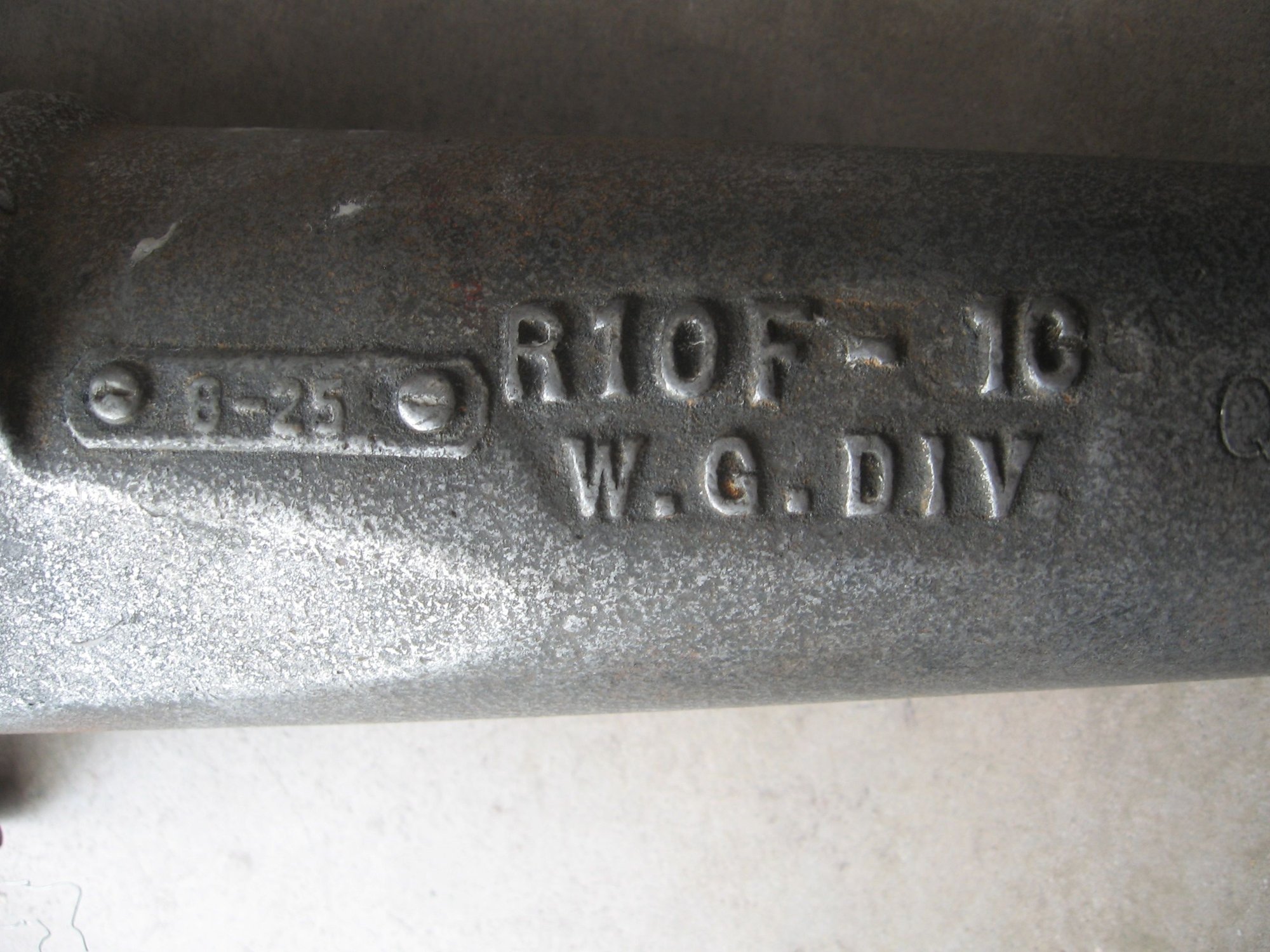

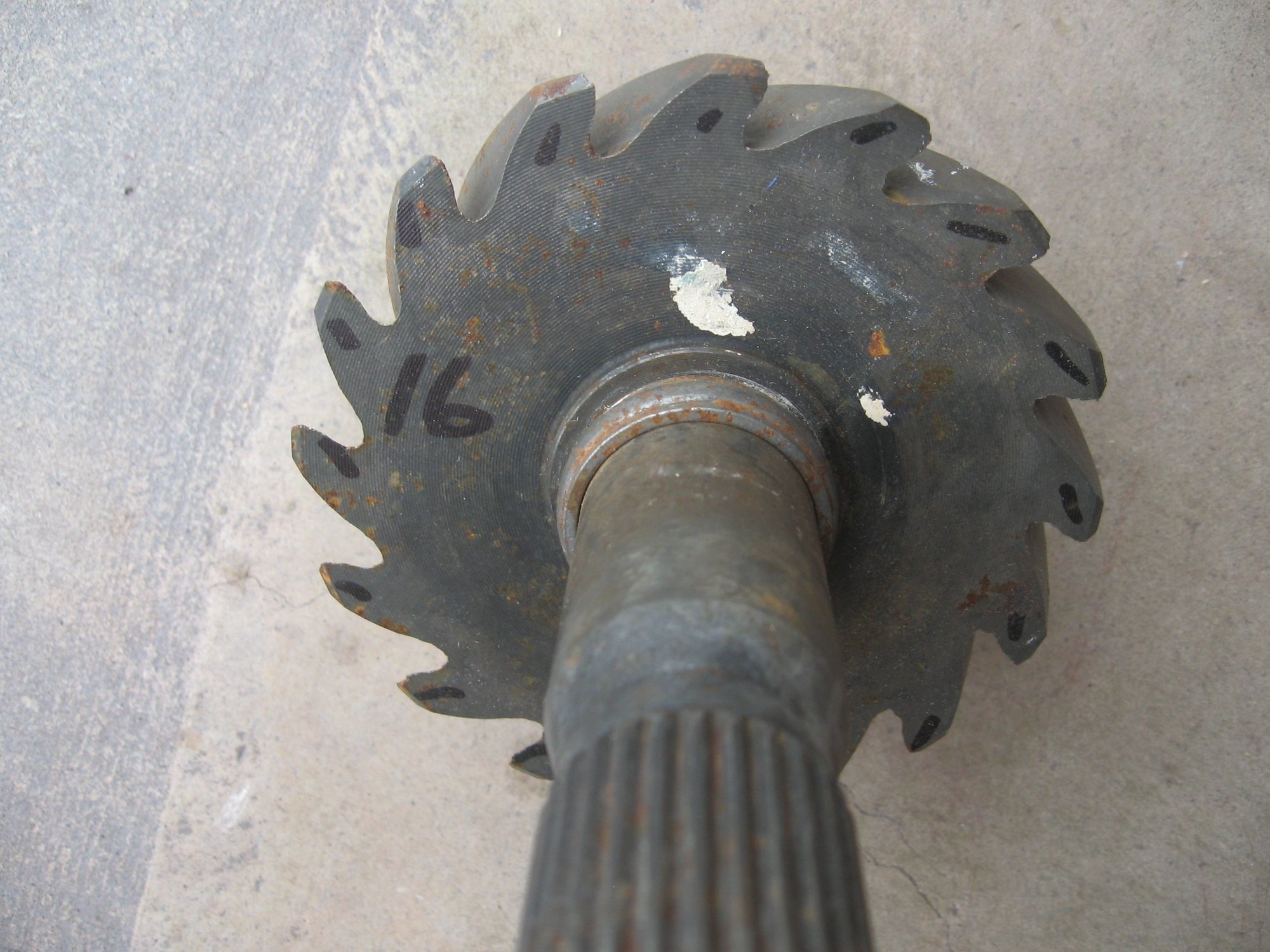

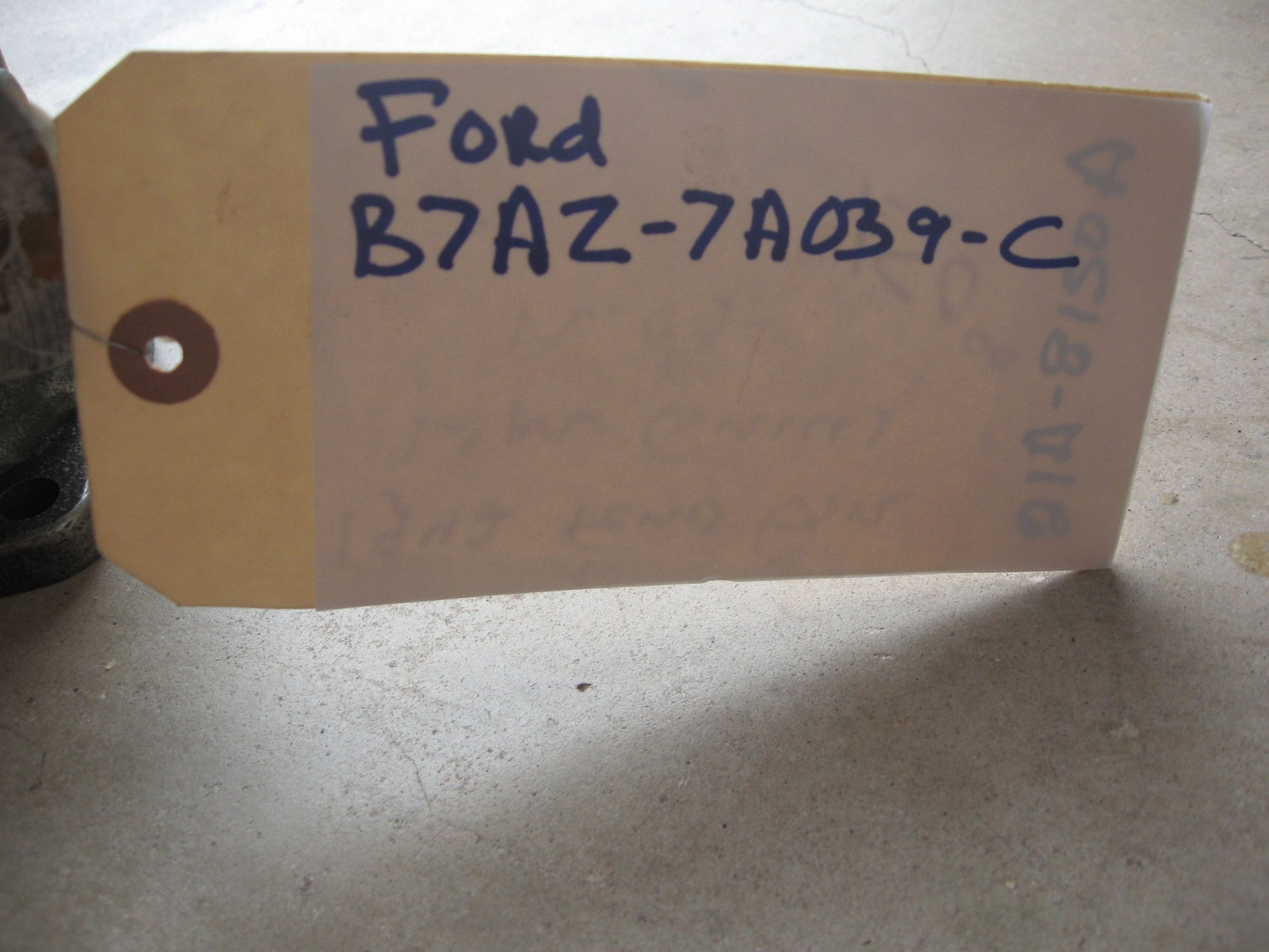

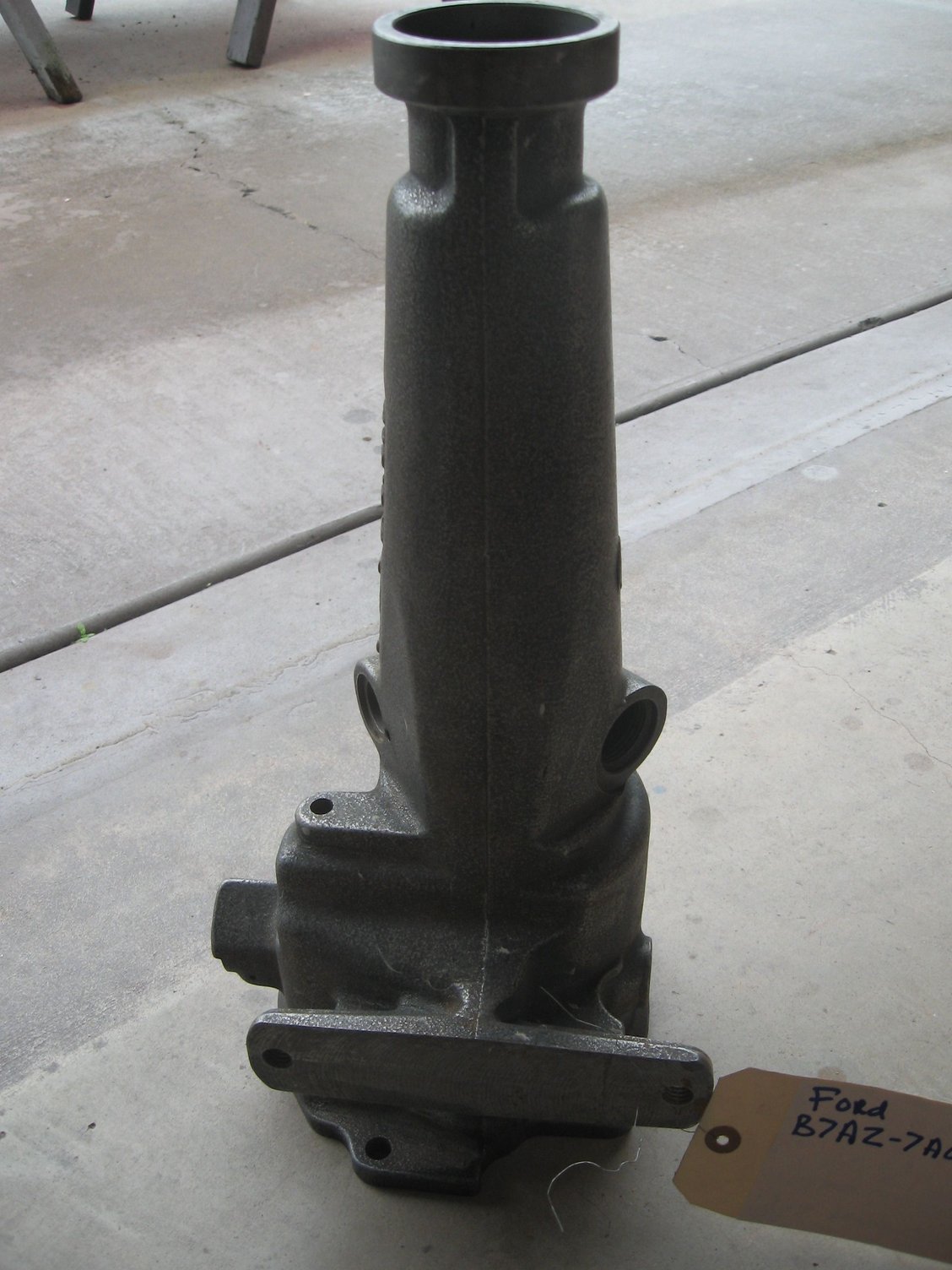

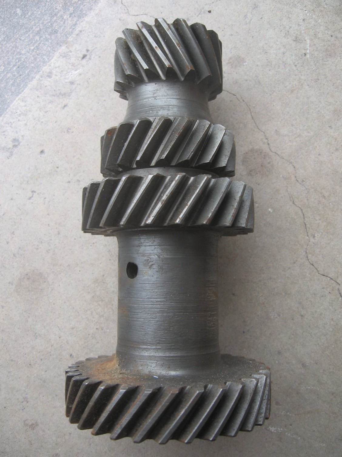

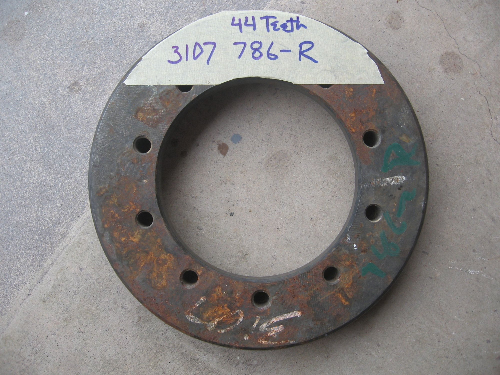

Need some help identifying some trans parts & a ring & pinion .All early or mid 50 parts All are NOS .

Tailshaft housing for R10 Borg Warner Overdrive to a light duty 3 speed. Can't imagine much going wrong with them. Might try calling Mac VanPelt and see if he's interested. (looks like the ones I have)

B7AZ-7A039-C .. Extension Housing-Use with Overdrive.
1957/58 Ford Passenger Cars 223/272/292.
Count the number of teeth on the cluster gear, are there any markings on it?
The 44 tooth ring and the 16 tooth pinion (ring & pinion) gears may go together (9" 2.75-1). See if there's any numbers like C7AW-H on the pinion gear.

Except for the cluster gear, too much rust IMO. Have you bought these, or deciding whether to buy?

Thank you CBeav , Bill & Ross . These are for sale . The tail shaft housing looked bad after the rain storm in Daytona last Nov. These are all NOS and were MIB until the storm . Put the trans housing in the shaker & it cleaned right up . Will lightly dust the other parts w/ the media blaster & clean them up .hanks again , Denny

No markings on the cluster gear . Cluster gear from top to bottom 16 teeth
19 teeth
22 teeth
30 teeth

Needle bearings have a low tolerance for pits in their race surfaces. Even if the appearance of rust is gone, if there are pits it they will eat bearings.

No markings on the cluster gear.
Cluster gear from top to bottom:
16 teeth
19 teeth
22 teeth
30 teeth
Cluster gears are very hard to ID without any numbers.
Possibly: B7A-7113-F .. Cluster Gear / 16-19-22-30 teeth / Obsolete
1957 Thunderbird 292 3 M/T (no O/D); 1957/59 Ford Passenger Cars 292 3 M/T (no O/D).
