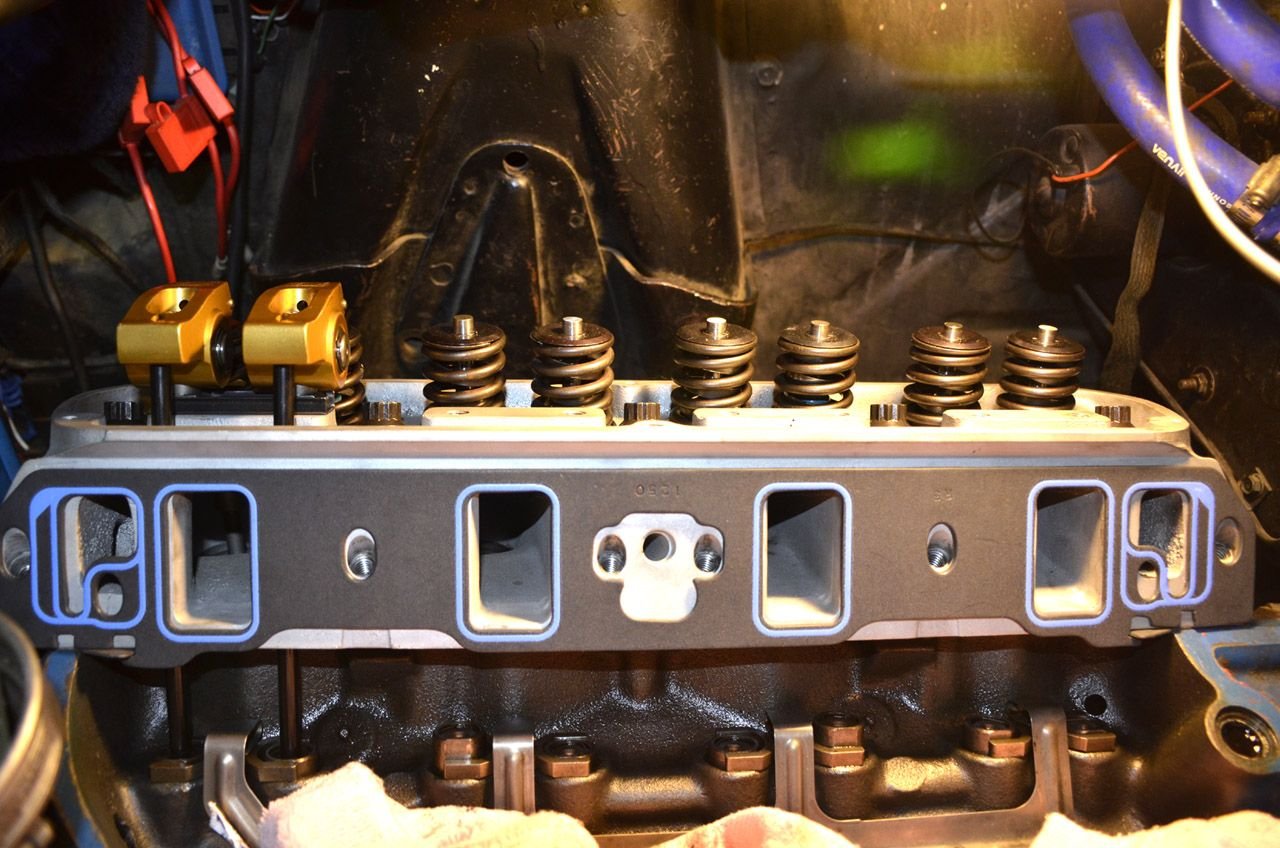

As I continue with my assembly, I noticed that the intake ports on the heads are quite a bit bigger than the outlets of the intake manifold.
Fel-Pro 1250 on Edelbrock Performer
Same gasket on Edelbrock F4B intake.
Would it make a big difference in flow to expand those openings in the intake to match the gasket? I can't port myself, in fact, I'm not sure if I can even do the port matching. So I would have to have someone do it. Would a full port add significantly to flow?

Port matching the intake would be labor intensive, if you have to pay somebody else to do this you would be dollars ahead just buying another intake that matches better. Gasket matching is never a good idea.

Port matching is just that. Matching the ports to each other as opposed to the gasket itself. Without a bore scope to see the end result after it's all torqued down, it's a crap shoot as to how it ends up on each port. If anything just take a grinding bit and chamfer the edges of the intake ports out to better fit the gasket and call it good.
