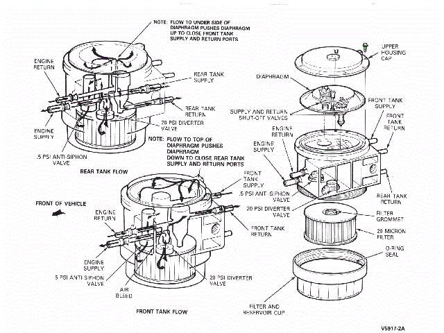

Brought my mechanic buddy over and boy did he earn his money today. Turns out it was the fuel tank selector. The fuel filter further ahead of that was working fine. The component that consolidates the fuel lines from both tanks was the culprit. Very little gas going from the front (currently only) tank was moving forward from there. Only thing we could do with the parts we could find at stores that were still open is bypass the selector entirely for the moment. With that done, fuel pressure improved dramatically. In fact, it forced us to replace a gasket on another old fuel injector that had been acting up a bit previously.

Sounds like you friend may have plugged off the return line that also goes through the selector valve.
If so the fuel pressure can go as high as 95psi.
Attachment 280309
Attachment 280310

Buddy said he connected the return line back to the tank, that it was not plugged.
