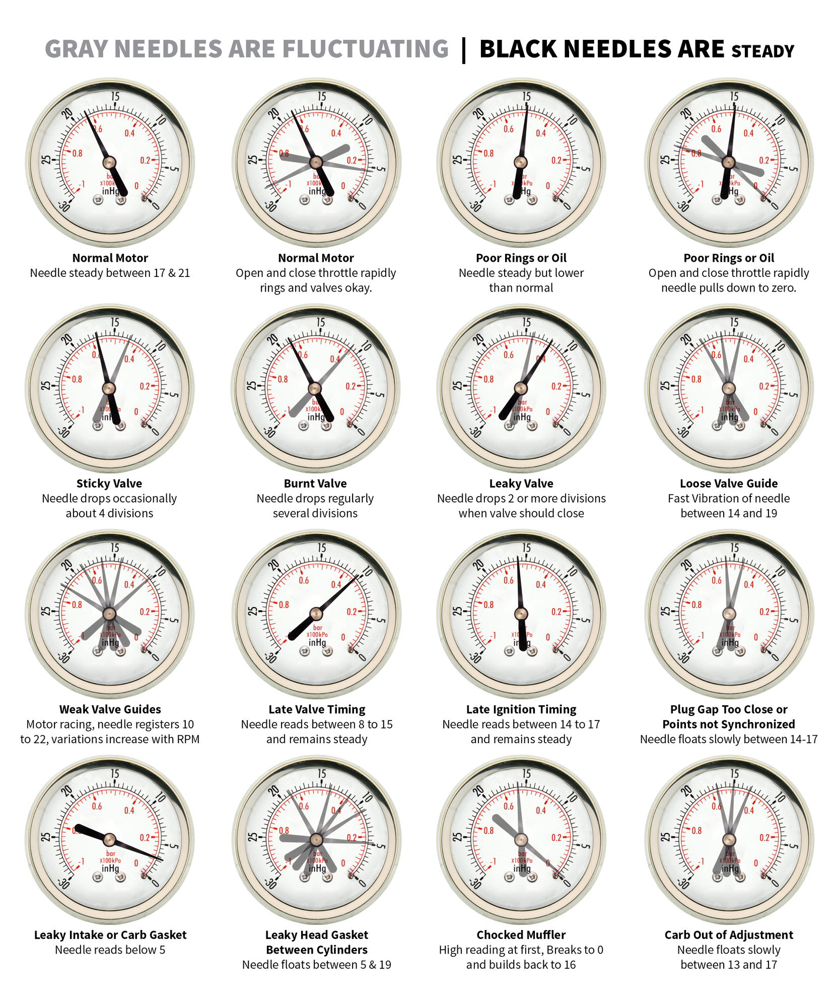

I looked over some earlier posts you made. Keep in mind a tune-up has a cylinder compression test as the first step. A vacuum gauge also measures compression, at least indirectly, very well but it's nice to know for sure what we're working with from the start. A bouncing needle on a vacuum gauge generally means something that affects one cylinder, maybe a sticking lifter or burned valve, or a broken valve spring. A generally low reading means something that affects all cylinders equally. Study the vacuum gauge charts carefully, there are probably 5 or 6 that are real good, commonly available to download online. There could be more than one thing going on here. You're getting closer to diagnosing the problem. The gauge doesn't lie, there is a defect somewhere in thar.

I was just looking at that chart, too funny. It looks like I'm leaning towards loose valve guide ... GREAT! I might swing by the parts store and rent a compression tester and verify TDC tomorrow. It'll probably be after dark on the east coast.

Yeah I saw that too. Loose valve guide sort of fits doesn't it? The gauge charts are usually really accurate too, it is amazing to me how many different faults and diagnostics can be done with those things. There's usually one or two different or extra faults on every chart, check them all out. Let us know what you find, it will help somebody else out. Make sure it really is what you think it "might" be, before tearing into it at least.

Another thing I thought about was a too-lean mixture. Is that listed on the chart anywhere?
