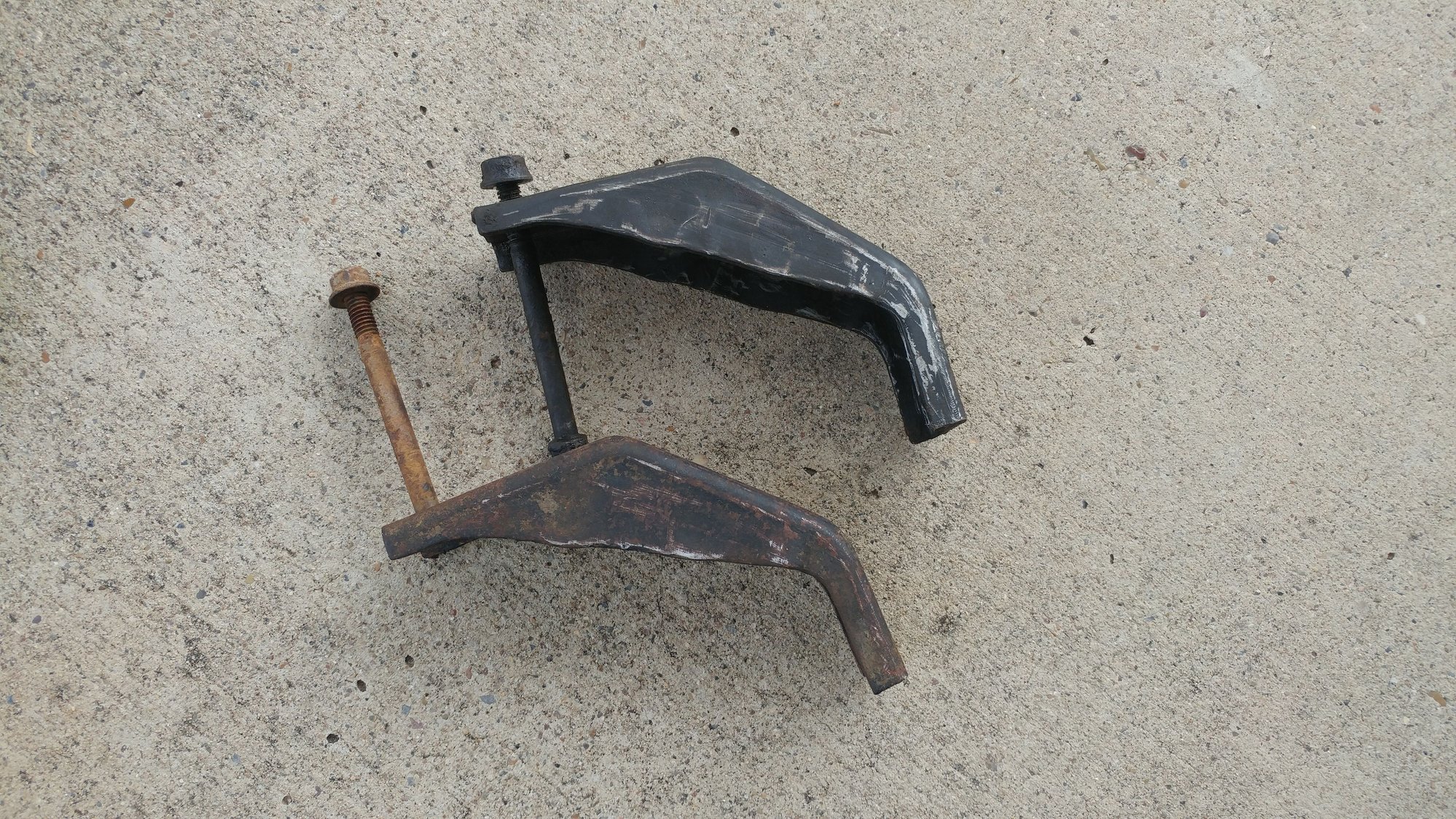

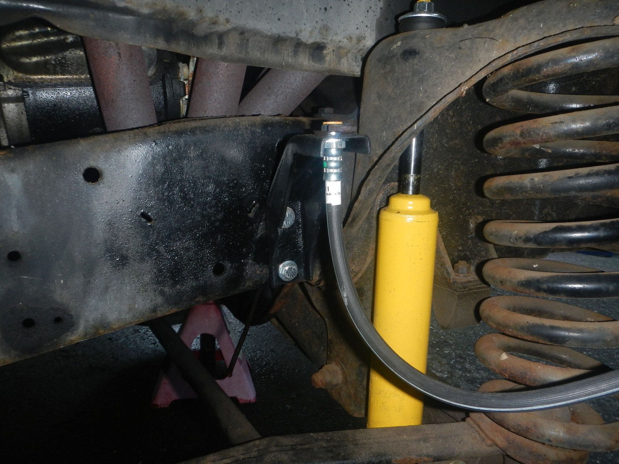

ONTMERC mentioned something about getting the hose bracket off the doner truck. I have heard this before on the forum. I have the front end off a 1979 F250 which I would like to put on my 65. Unfortunately I do not have the hose bracket.
Does anyone have a picture or source for this bracket as well as where exactly to located it.
Thanks

Sorry for interrupting this thread.
However I bought the ebay brackets now where do they go or should I be able to figure it out when it's together.
Thanks

Here is another picture of the 1973-79 disc brake hose brackets. The brackets are just behind the spring mount on the frame,on donor truck one side is held on with two bolts other side is one bolt one and rivet.
