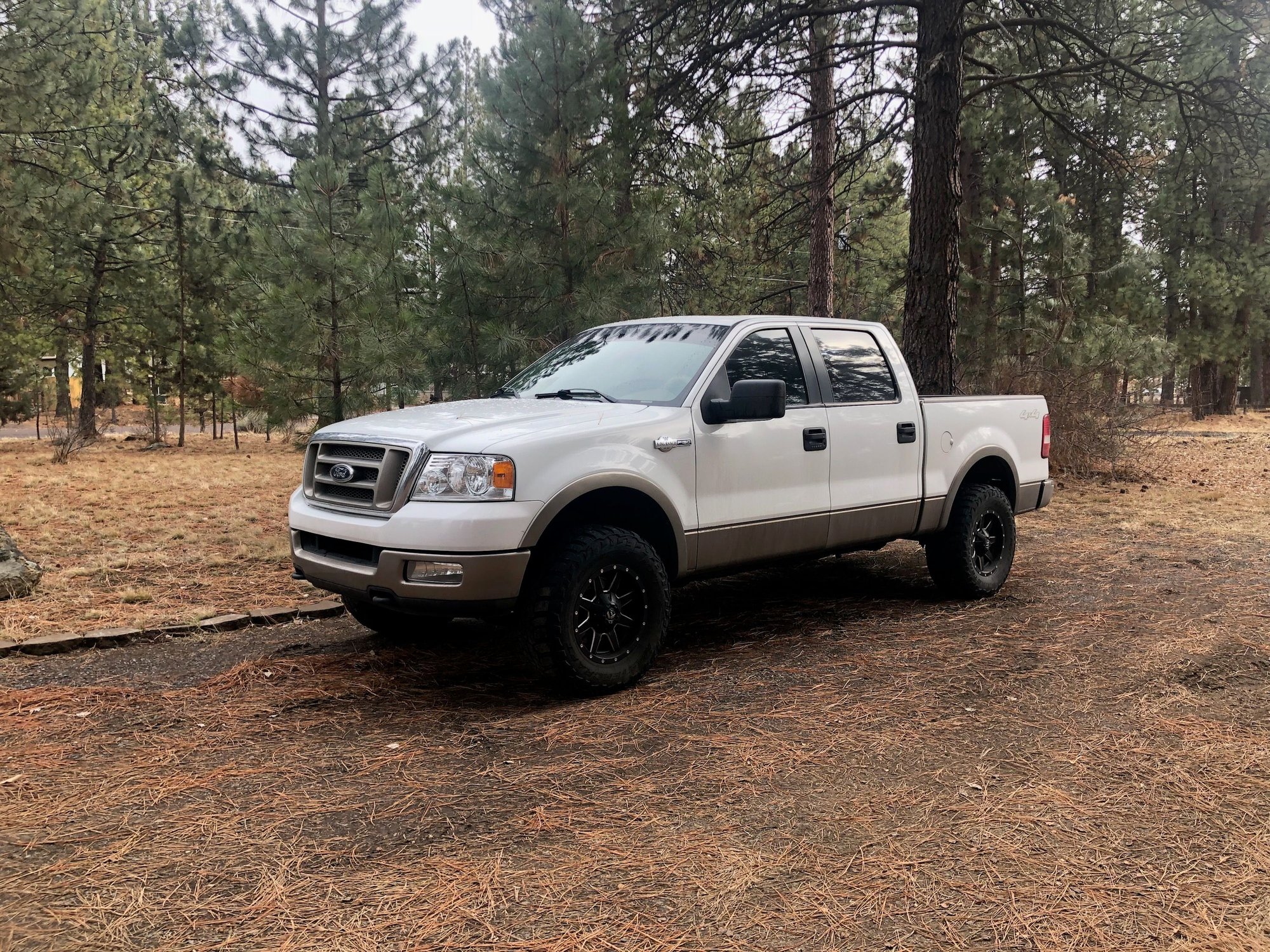

Possible purchase 2005 king ranch
so was 3am when I woke this am. I’ve got to get some suggestions regarding this truck (2005 F-150 king ranch) I may purchase today. Some history, the truck has 172,000 on it, a transmission rebuild was done at 170,000. Cam phasers have been addressed and all injectors have been replaced. Front and rear axles are clean, no leakage, rear main seal no leaking, suspension is solid aftermarket ties and wheels. Which the wheels were downsized to 17’s from stock 18’s. Engine harness looks clean no additional wiring, interior is well king ranch... all windows and sun roof work.
Here’s my question. I’ve no history with the 5.4 Triton. Or any newer truck from the 2000’s. The fella is offering 6500.00 for the truck. With all I’ve explained here, is there anything major I’m missing? Any suggestions?
thanks in advance!
