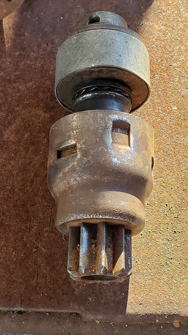

The starter driver on my truck (1959 F350 223 T98) has gone bad. I had been using the starter to turn over the engine occasionally while I hunted down and fixed an electrical issue in my ignition system. During my testing the stater got jammed up. I pulled it starter and the drive was stuck open. I used the wire wheel on bench grinder to spin it and applied preasure.. (I tried both directions, just in case) and I couldn't get it to close.

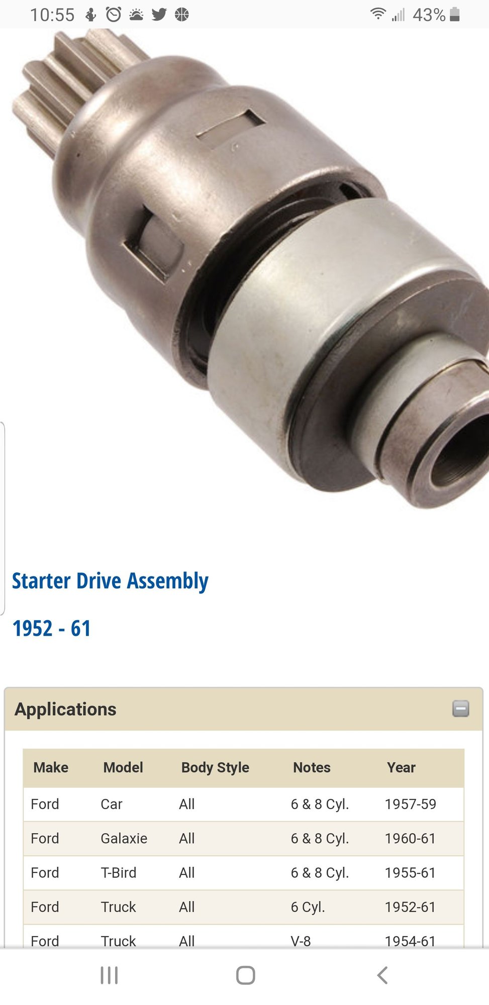

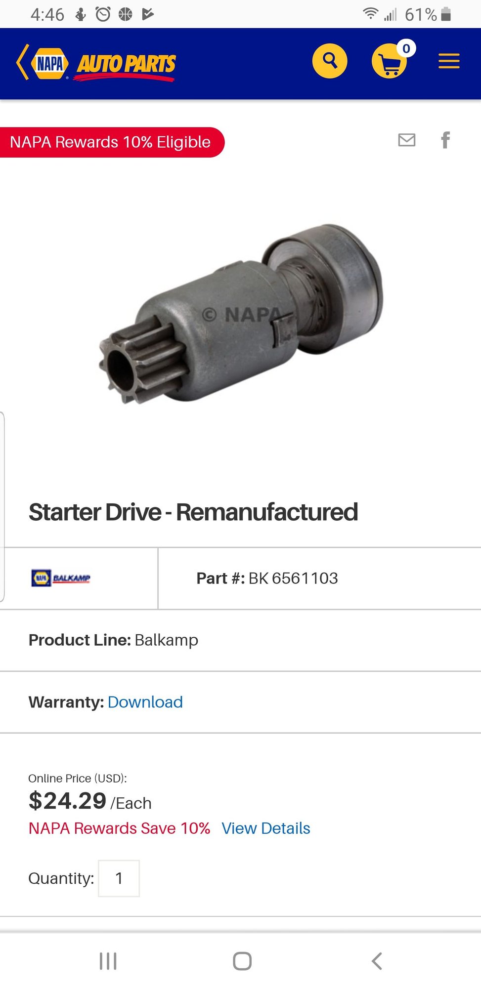

Yeah, I need the whole assembly. The one in your diagram is the one that Napa lists as correct for my truck. But not the one that's in my truck.
I actually just checked Dennis Carpenter and they list the one that is in my truck now as the correct one.
I really wonder if they are interchangeable.

This is the one Dennis Carpenter lists, it's the same as the one in my truck.

This is the one Napa lists as correct, which looks like the one in your diagram
223/292 is the same, but A/T is different than M/T
