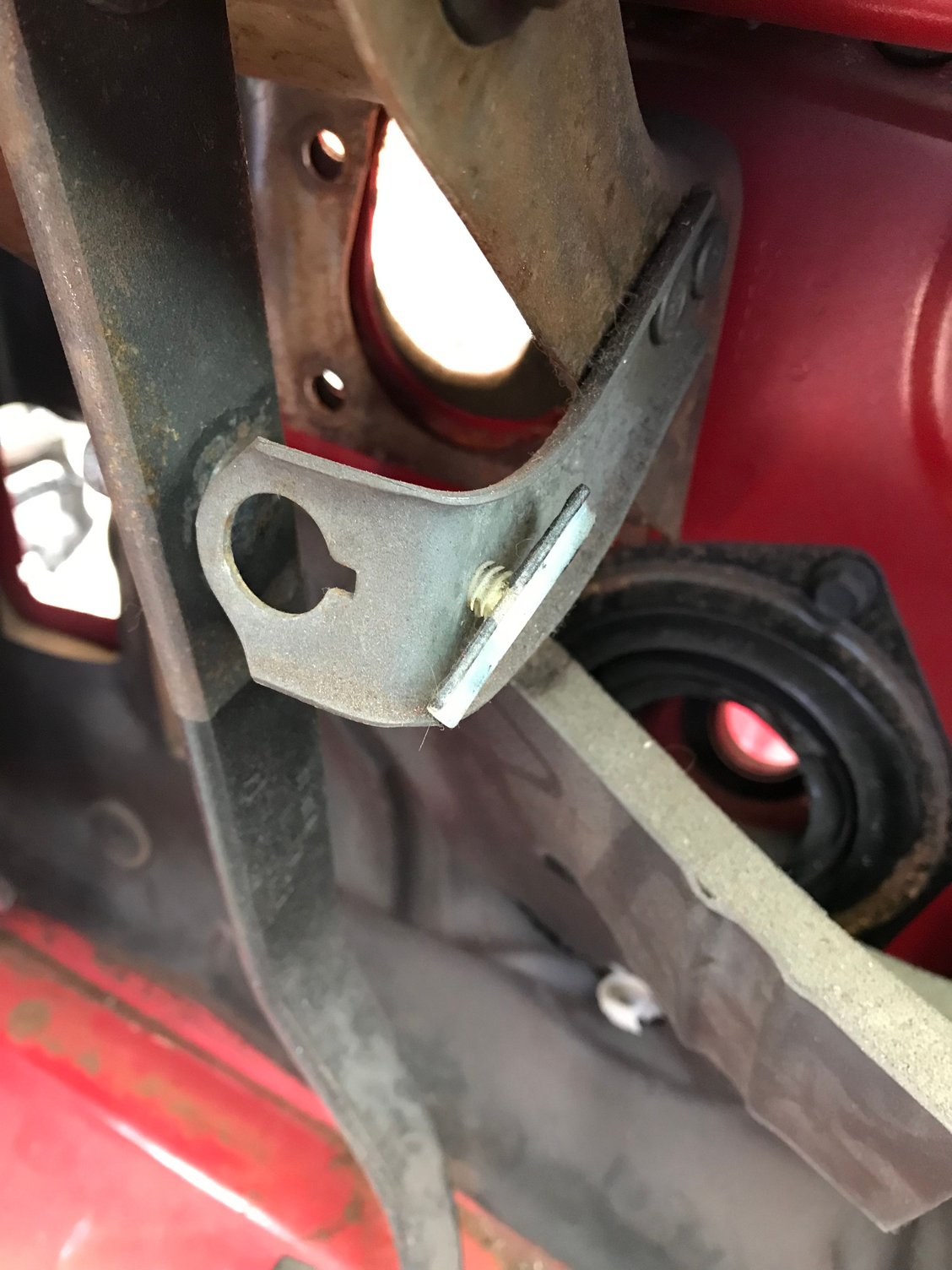

Hey guys. 1992 Ford f250 with 460. My brake vacuum switch has no plate or surface to depress the plunger so my cruise doesn't work. Is there or was there some type of plate attached to the brake pedal? A pic or suggestion is greatly appreciated.

Yep, it looks like this
