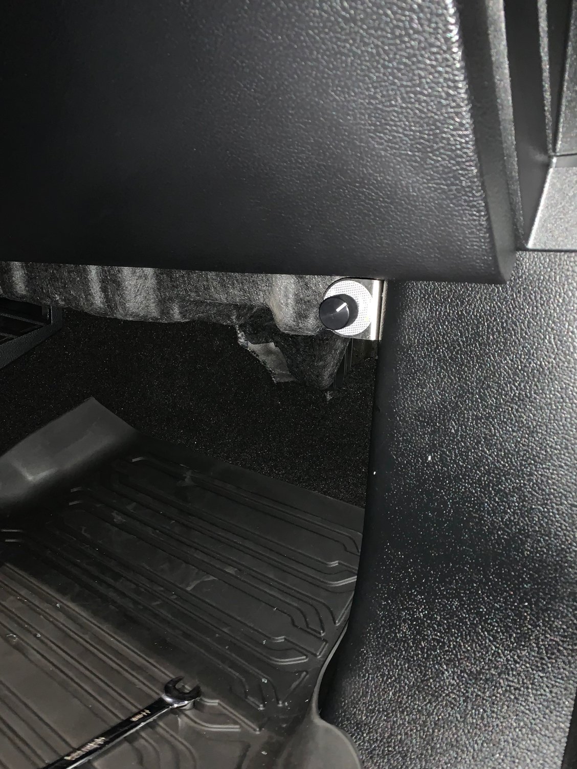

Mounted mine on the passenger side. Set it in and forget it. I heard 1250 rpm is the sweet spot

Mattymax - I plan on leaving mine switched off as I don’t want it to activate every time I pull into the driveway and set my parking brake. I will probably mount it on the drivers side or maybe in one of the console compartments so it’s out of the way.
