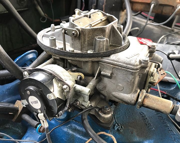

Hello guys. Here is what I have. 1973 F100 360 V8. 2 bbl carb. Pretty standard stuff. Temps here in Tennessee have been averaging 20s or so in the morning. I turn the key give it one stab and the engine starts on the first crank with good solid idle. After a minute or so I stab it again and the idle falls to about half and I can back it right out of the garage no issues. No fits or misses. Upon driving it away the engine wants to drop out or hesitate and I need to "goose" it a time or two to keep it running until it catches and then accelerates pretty normal. After it warms up there is little to no
hesitation at all. What could cause the engine to want to stall at very low speed and that from a stop upon acceleration? I think I have the choke set properly but can't seem to find why it wants to die on me. Any suggestions would be helpful. The photos show the choke re-set so I could try driving it at this "new" setting to see if it makes a difference. This is where the butterfly is after about three hours of sitting. It is now about 42 degrees outside. Thanks. DO'

Maybe adjust the electric choke coil a notch or two richer and see if that helps, then set it back to where it was when the morning temps come back up.

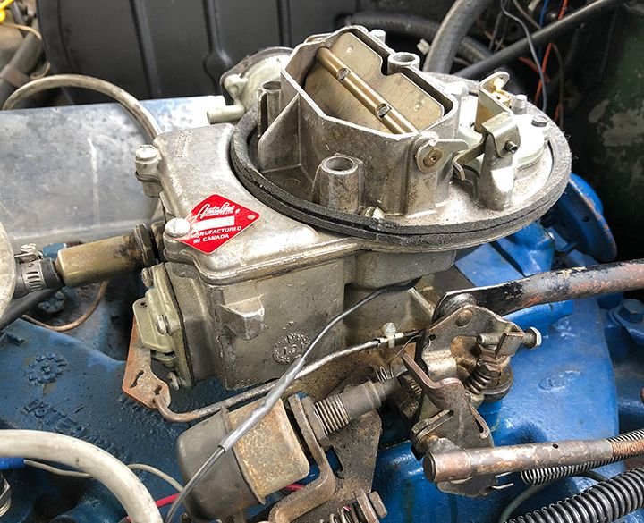

The carb has been rebuilt based on the tag in the pic, professional outfits will re-bush the throttle shaft mount holes if they are wallered out. I don't think this is the problem. Maybe. Could try stuffing chassis grease in there, and see if the problem goes away.
