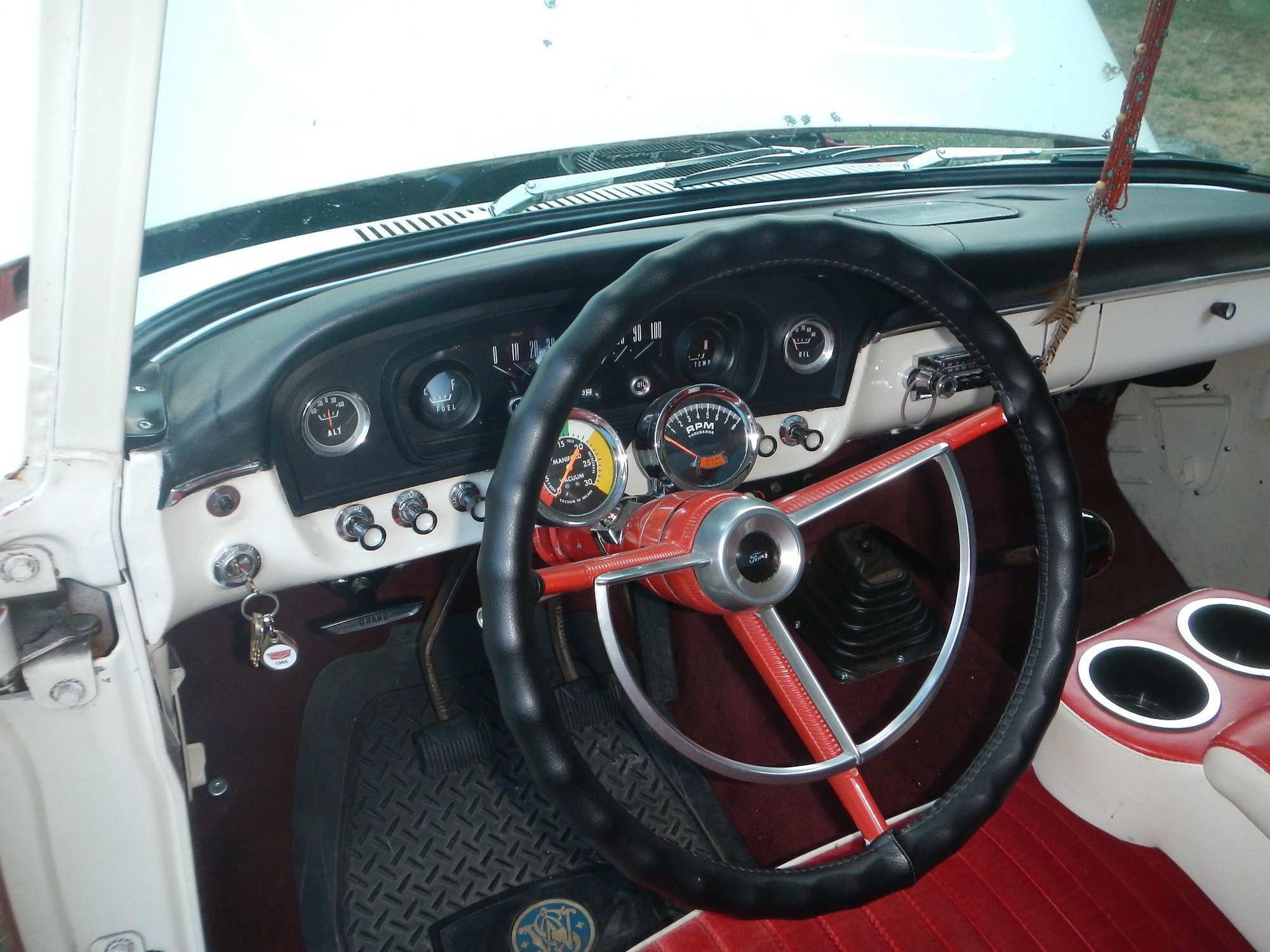

For me it's the KISS method. Repop or paint.
Old Feb 9, 2019 | 01:30 AM
sawmaned's Avatar
sawmaned
Joined: Aug 2014
Posts: 865
Christmas, that is very nice
Old Feb 9, 2019 | 02:35 AM
Christmas's Avatar
Christmas
Joined: Jun 2018
Posts: 3,554
Likes: 442
3 yrs ago
