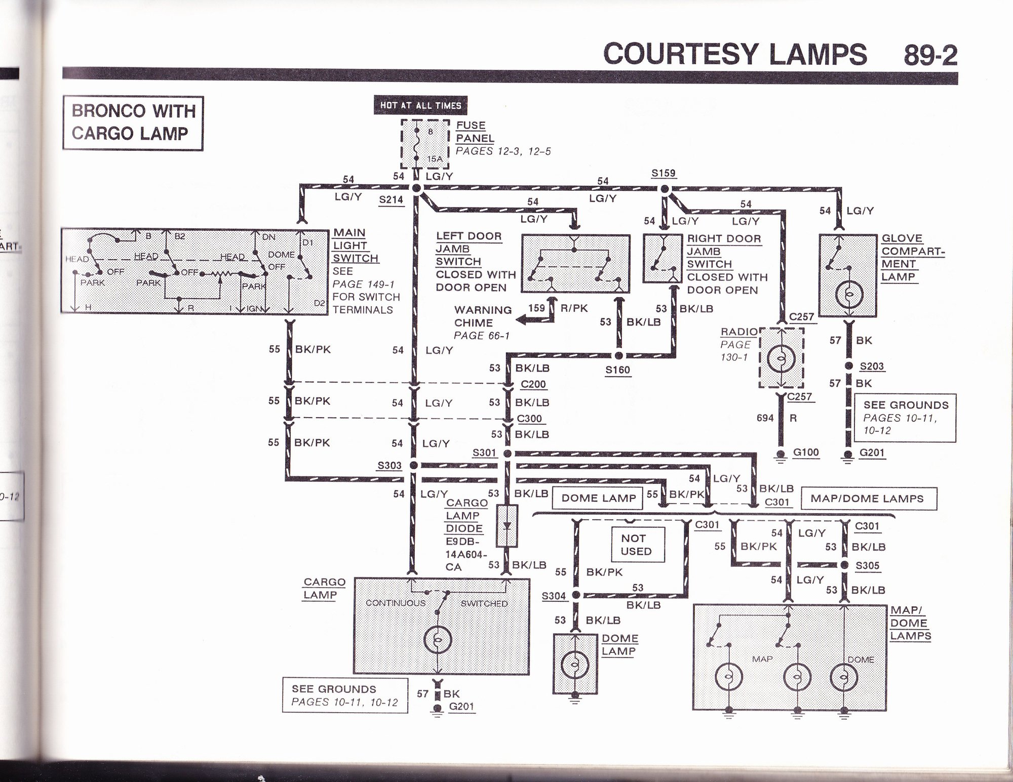

I have a 1990 bronco that someone has messed with the electrical system can Simone please respond with some detailed pictures of the wiring that goes from the 5 prong connector under the kick panel that runs power to the dome light, and the cargo light.

Welcome to FTE.....
