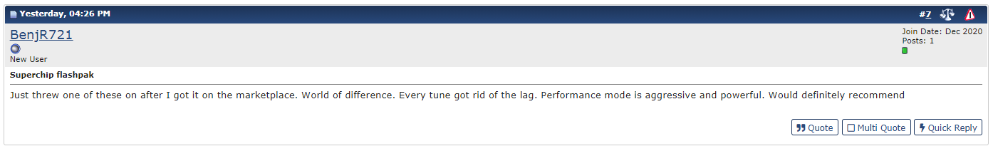

Superchip flashpak
Just threw one of these on after I got it on the marketplace. World of difference. Every tune got rid of the lag. Performance mode is aggressive and powerful. Would definitely recommend

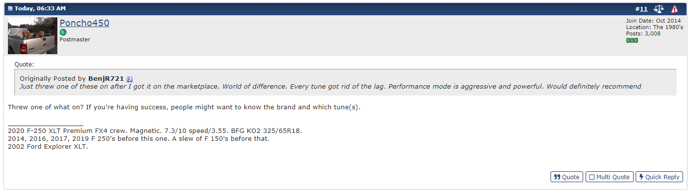

Threw one of what on? If you're having success, people might want to know the brand and which tune(s).

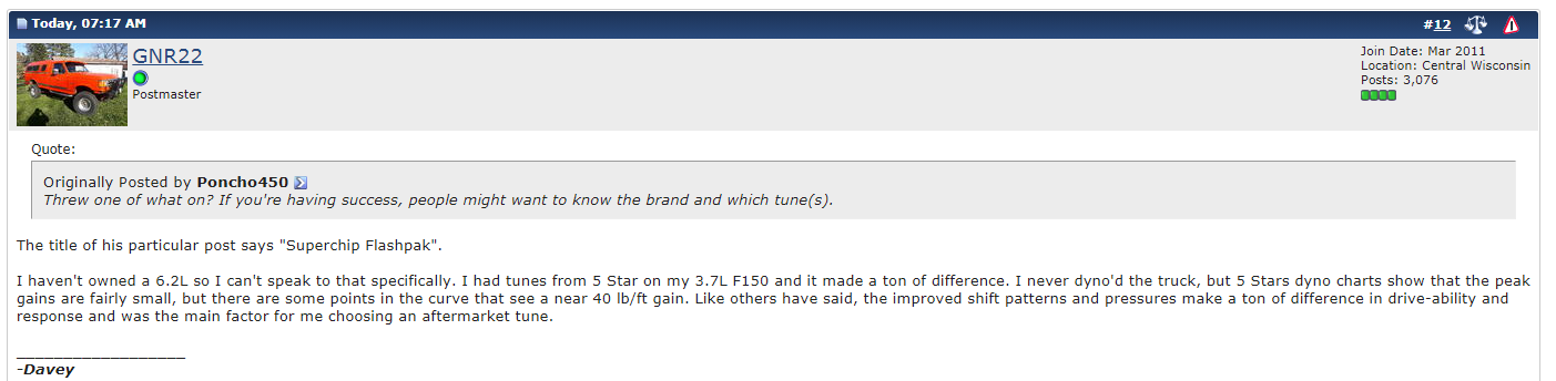

The title of his particular post says "Superchip Flashpak".
I haven't owned a 6.2L so I can't speak to that specifically. I had tunes from 5 Star on my 3.7L F150 and it made a ton of difference. I never dyno'd the truck, but 5 Stars dyno charts show that the peak gains are fairly small, but there are some points in the curve that see a near 40 lb/ft gain. Like others have said, the improved shift patterns and pressures make a ton of difference in drive-ability and response and was the main factor for me choosing an aftermarket tune.
