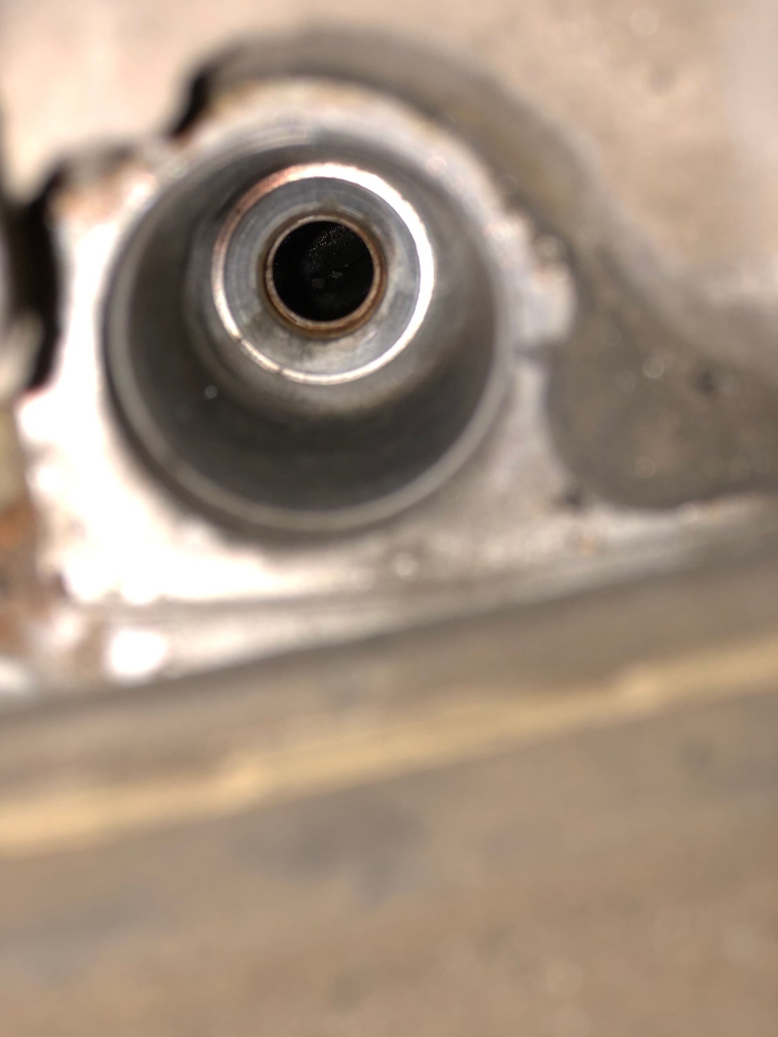

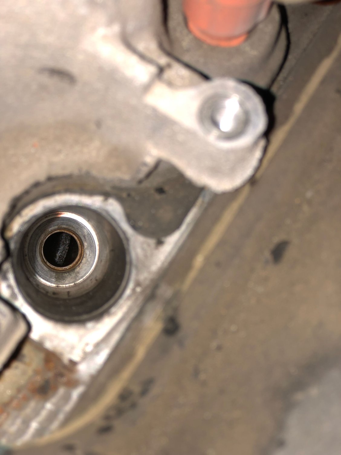

#6 good

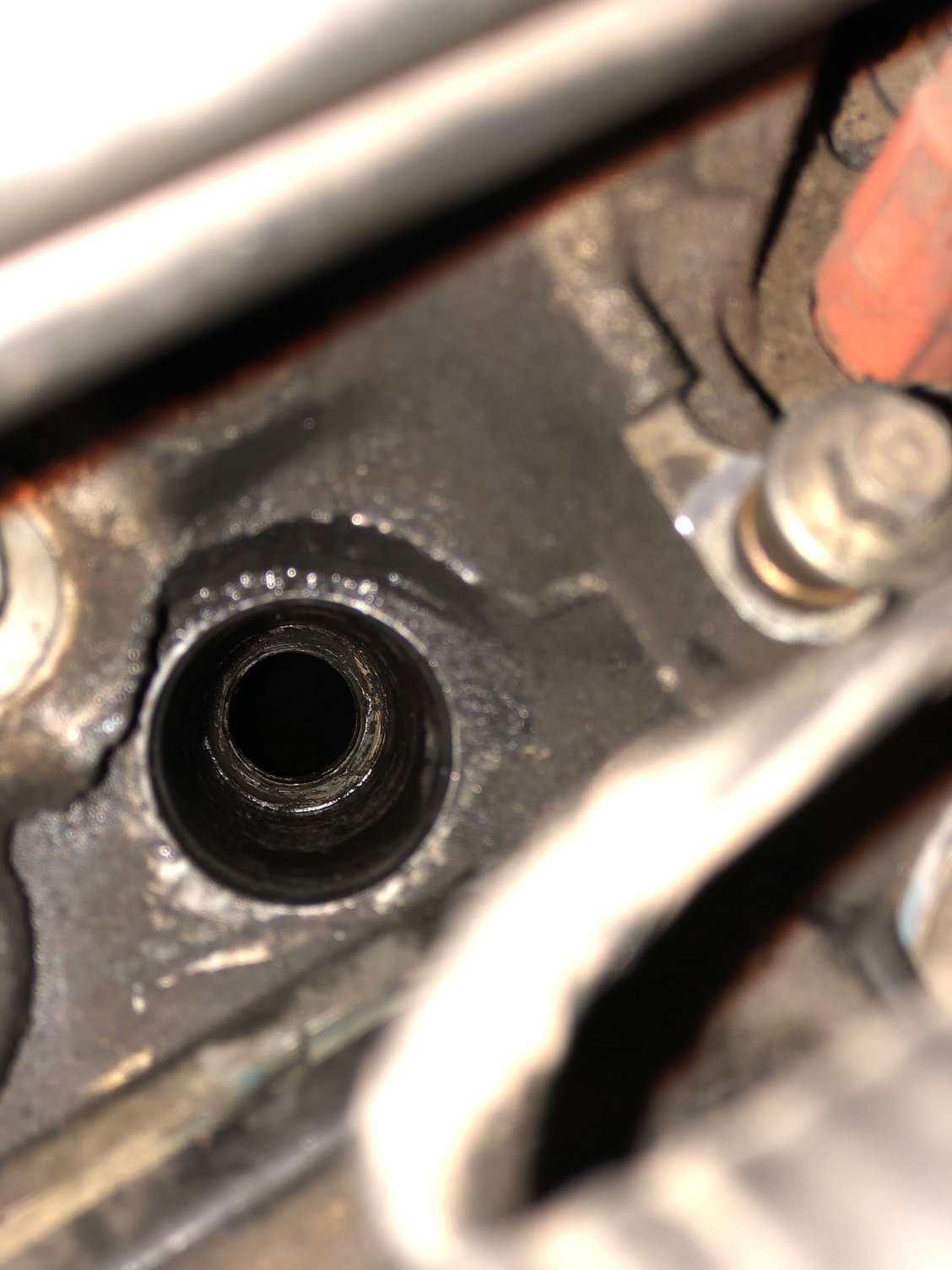

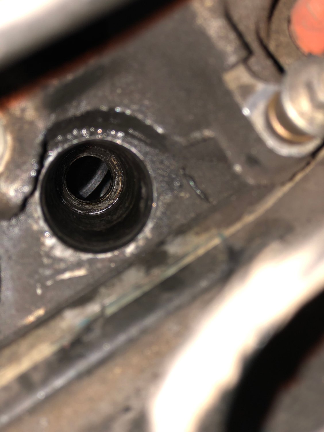

#8 bad looks weird down there. But so does # 6.

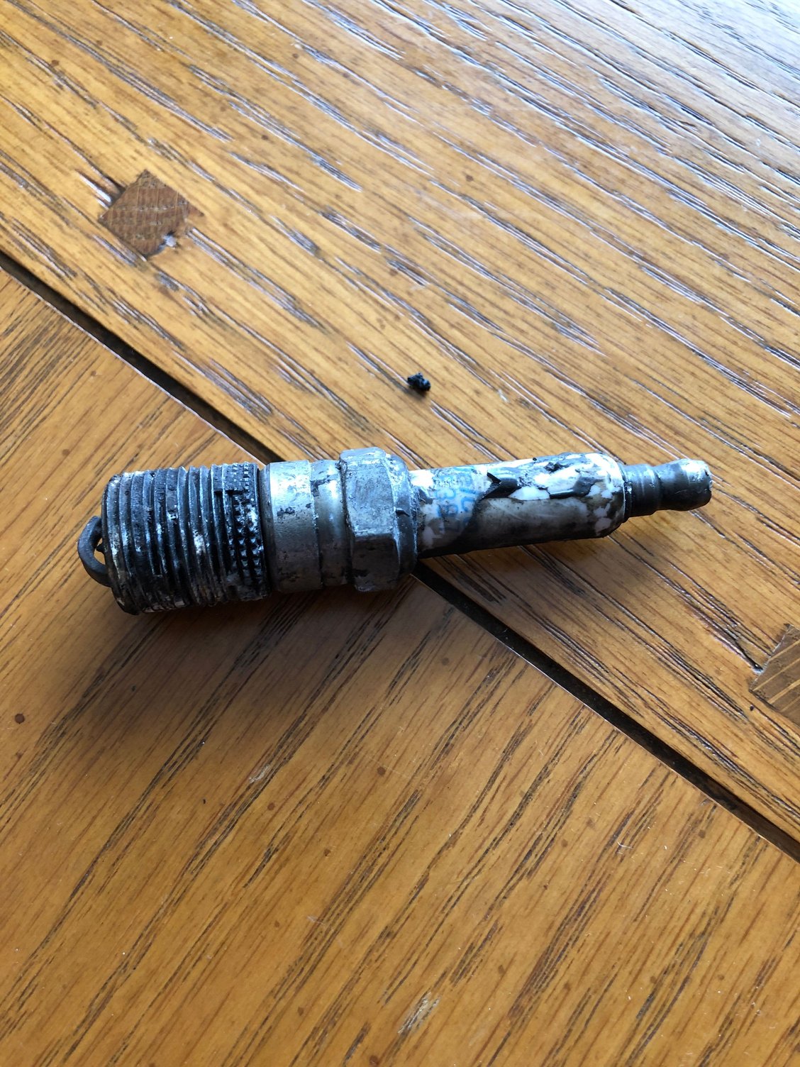

Ok so two days ago we drove several hours to pick up a 2002 E450 minibus for our gospel/bluegrass group. Has the 6.8 V10 motor with 80k. Upon returning we had a check engine light which pointed to misfire at number eight cylinder. When I looked at the COP I noticed it was unplugged. And broken at the mount. I plugged it back in and the vehicle ran like a top. Drove it half mile down the road and it spit out the number eight spark plug. I’m assuming it has done this in the past which is why the coil pack was broken. Now my question is have they tried to helicoil this at some point because the hole to me looks a little larger so might be a spit out the Helicoil if that’s what. This is a bummer! Especially When we had a budget. It was a private party sale so this will be our problem I’d say. We drove it 400 miles home. I tried to thread a plug into it and no go. I think the hole is too large? Is there a way to tellif it’s already had an insert. Posting pics. One pic is the good number 6 hole. Other is the bad #8. Any help appreciated. Especially since I’m the one who thought we should get this one. Lol.

I can actually get to that one ok I’m pretty sure. Actually have some room. Over that one. It’s halfway back. My main concern as shown in the pic. Is there something in that cylinder???but like I say the good cylinder looks odd also. Hoping a previous insert hasn’t fell in there. Surely it blew out.

It looks to me like you are guessing correctly, that it has had a repair insert fail and eject the plug still screwed into the insert. You might find the spark plug laying on the intake or in the valley somewhere or it may have hit the road.
What you are seeing in the cylinders is probably open valves or the top of the piston.
I Would get an inspection camera inside it to scope it before and during the repair at each step.

Didn’t think about may be the valves I’m seeing. I’m gonna scope it. That eases my mind a bit. Couldn’t find the plug. Maybe it’s still laying there but I’m thinking it hit the road. I drove right back to see if I could see it. Maybe in daylight. Would really like to find that plug, and the insert attached would be wonderful! Plus I could measure the size of the insert. I def think there was an insert. That hole is larger looking at the pictures.
Im just hoping I’m seeing a lot of shadows in there and that it is a valve I’m seeing.
I’m hoping I’m seeing a lot of shadows in there. And that is a valve.

What is that in the head?

After a few passes down the highway. I found the plug. All intact. And already has an insert. Helicoil I’m figuring. Thankfully at least it all went up and not down! Fixing to scope.

Back to the OP's found plug: that looks like a CTA plug repair kit. That kit doesn't use an insert with a shoulder that really seats against the head. HOPEFULLY it just backed itself out and didn't damage the threads. You may be able to work a new Time-Sert in there, but I wouldn't be 100% certain it won't fail again having another repair already back out.
