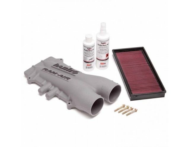

Yep, 300/460 tube wins here. Also stick to a conventional filter, no need for the so called performance ones.
Funny how Banks doesn't even seem to know what Ram Air is. Lol... Is that even the whole kit they offer? I can't say I see how that is worth doing.
I had the FIPK junk many years ago and was extremely disappointed. It offered no increase in performance or fuel economy, and I actually think the truck ran worse with it.
It appears to only replace the OEM air box lid. My guess is they found the factory stuff was pretty good as is.
It could be. What does the replacement air box top actually do though? Can't really see it improving anything.
It won't.. and that is the point people are making.. this is just a scam.
Yeah, I knew it was, but just wondering why Banks would even sell something like that. Not very good for their image so to speak.
