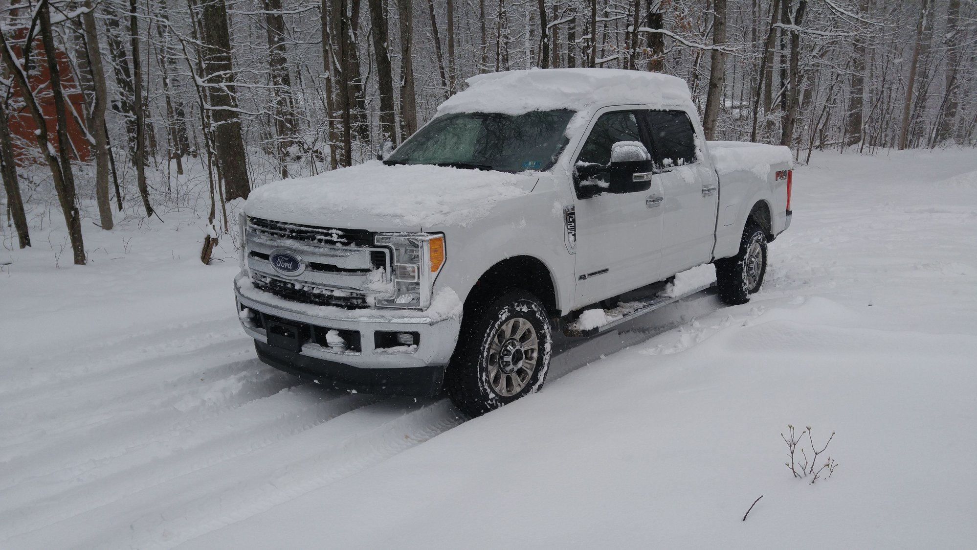

That white truck sure looks good in the snow.
