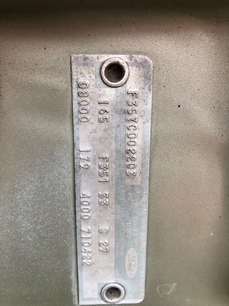

Warranty Plate riveted to the left door face below the latch. Post a pic of it or type all the codes stamped on it.

Thumbs up Heres the picture of the tag!

Originally Posted by Gill Nets
F35 = F350.
Y = 360 2V
C = Oakville Ontario Canada Truck Assembly Plant.
D02203 = 1968.
165" Wheelbase.
COLOR: Blank, truck painted a non standard color per the original purchasers request.
F351 = F350, 8000 lbs. GVWR
33 = Medium Beige Crush Vinyl & Medium Leeds Pattern Woven Plastic - 81A Standard Cab.
G = C6 Automatic Transmission.
27 = Dana 70 Rear Axle / 4.10-1 / 7,400 lbs. Rear Axle Capacity.
8,000 lbs. Gross Vehicle Weight Rating.
179 net HP @ 4,000 RPM
710422:
71 = Los Angeles (SoCal) Ford District Sales Office, where the original selling sealer ordered the truck from.
0422 = Domestic Special Order number, truck ordered special by the original purchaser, not "bought off the lot."
Another way to tell this is a 4WD conversion. 4WD not available with A/T until 1973.
VA = Your F350...is a loong way from LA LA Land, where it first resided.
If you get a deluxe Marti Report, you'll get additional info on your truck, including the name of the dealer it was ordered from. It might still be in business. martiauto.com
