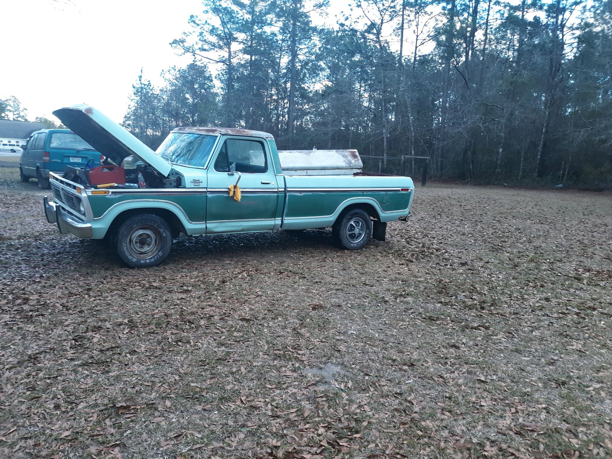

So today's goal was to get this thing clean, finally. I've been putting it off for quite some time for one reason or another, but now I finally got the job more or less done. It took me at least four hours between bouts of rain to manage to scrub it down as well as I have in the final pictures here. I know some of them are out of order, but my camera took the pictures but left me with nothing to show for some spots I intended to highlight.
Tomorrow I'll be going back to clean the bed out, finally and to finish washing up the truck. Might even get so far as to get my brakes bled and go on another little adventure to test her out. First things first though, I've got to attack the under hood area, get all those leaves out and all that mess off the intake manifold. That thing is a fire just waiting to happen, and I know it.
Also for everyone that couldn't watch the video earlier, it has now been fixed and the link should be working.
About half-way through the passenger side wash. So much filth came off this side.
There is still dirt embedded in the paint here, but I kind of dig the patina going on with the primer coat showing through the green. It's growing on me, for sure.
It took me at least thirty minutes to get this far in the wash, I literally SCRUBBED as hard as I could to start making a dent in the filth on the hood.
Worst part of the hood rot, other side is still more or less solid but this cancer here has me concerned.
Forgot to start taking pictures while washing the drivers side. Here it's about 95% done.
Had to get a nice side shot. Truck looks so good from a distance. I need it to look this good up close.
