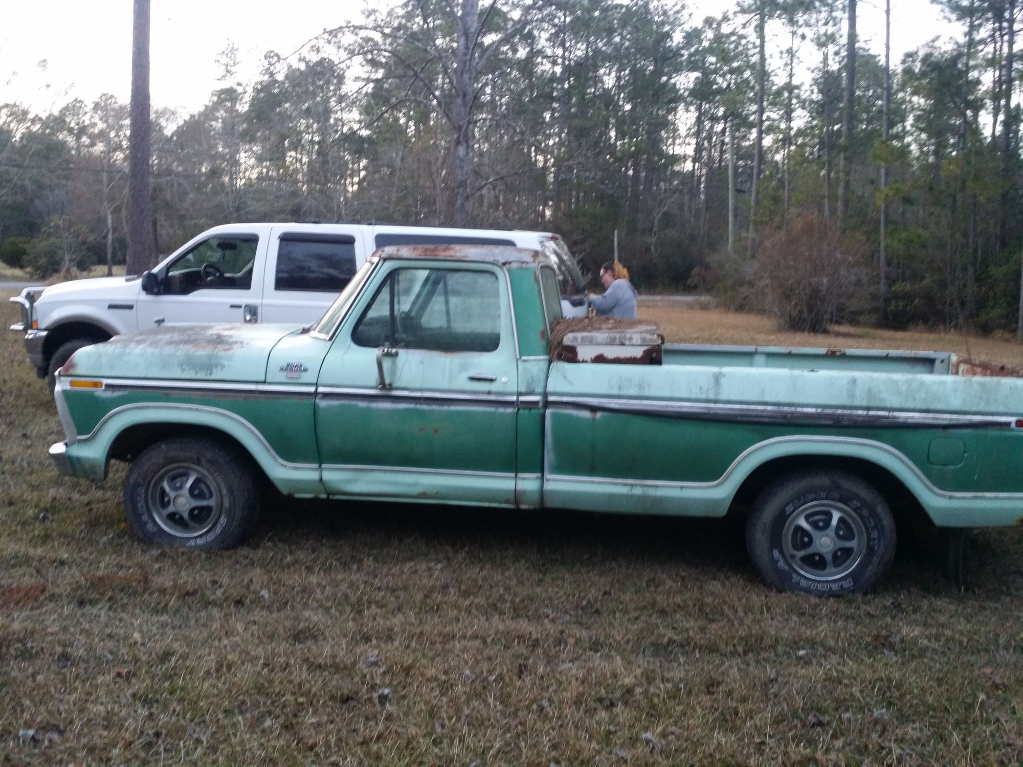

Guys I really think I've got a sickness, and it's these old Ford Trucks. Bought a new to me 1977 F100 last week, and finally got in the time to go turn wrenches on it to bring it back to life. When I bought it, the engine was frozen. Since then I've managed to work it free and it now turns over pretty smoothly.
I spent today pulling wrenches on the girl. I installed a new cap, rotor, coil, wires, and plugs and gave her a fresh oil change. Worked the carburetor free and it should be functional at least now. (Probably will have to pull it and dip it, and kit it afterwards.)
Transmission fluid is still a nice red, and does not smell burned so I've got that as a plus. Tires still hold air, even though they are pretty much shot at this point. She's got typical rust in the typical areas. Concerned about the cab seams and the drip rails the most, but that should be fixable at this point.
Anyway, here's to the pics. Used my "tank" Excursion to free her from her grave, pulled her out like a champ!

It looks like a nice project. Stay in touch.

Heck yeah.... that looks like a good 'un. I bet she looks a lot better after a good bath.

Very nice. Looks in pretty good shape for a Mississippi truck that's been sitting a long time. I like it.

I know the history of this one fairly well. It was more or less a family heirloom that was passed down in a close friends family. It has been babied it's entire life, and always well maintained until it got put out to pasture.
My knuckle head friend broke the shift rod that runs down the column, and the ignition switch failed is why it got parked. I'm hoping that it will come back fairly easily, as even after a twelve year nap it did not fight me one bit on breaking free, nor rolling out of her grave.
