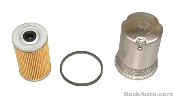

The pump filter looks like this:

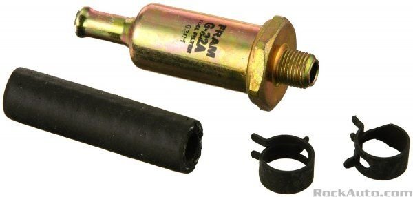

The carburetor filter looks like this:
