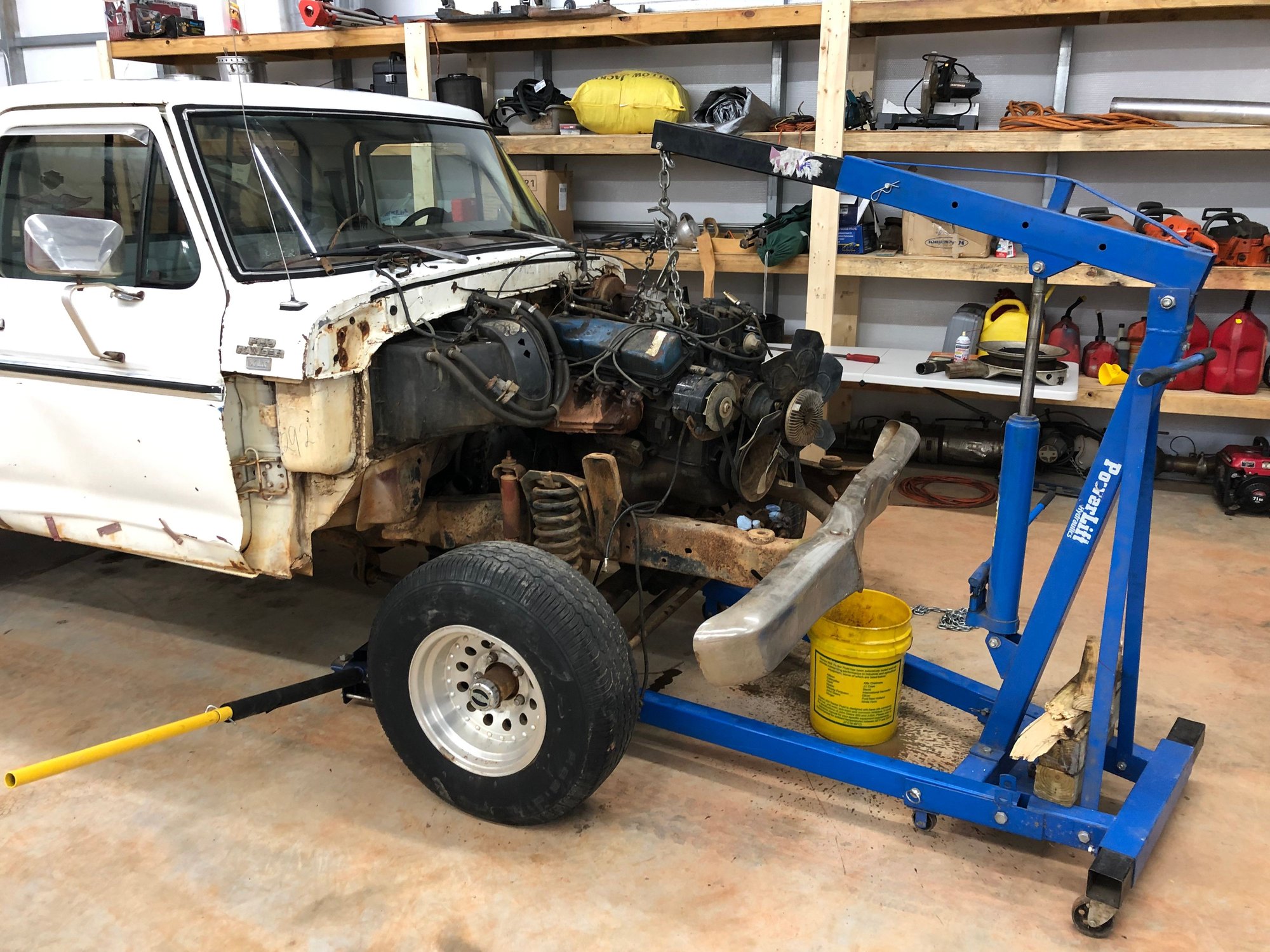

Yank the front clip
comes off in about 30 mins with a helper. Much easier for the swap, ive done it
front core support body to frame bolts
3 bolts on each side that bolt to cab
bolt on bottomof each fender
open door and bolt right there on each side for fender, need a ratchet wrench or shallow socket
bolt for rubber strap to cab inside each wheel well
unhook wire connector for headlights and drain radiator and remove
remove battery and unhook starter solenoid
