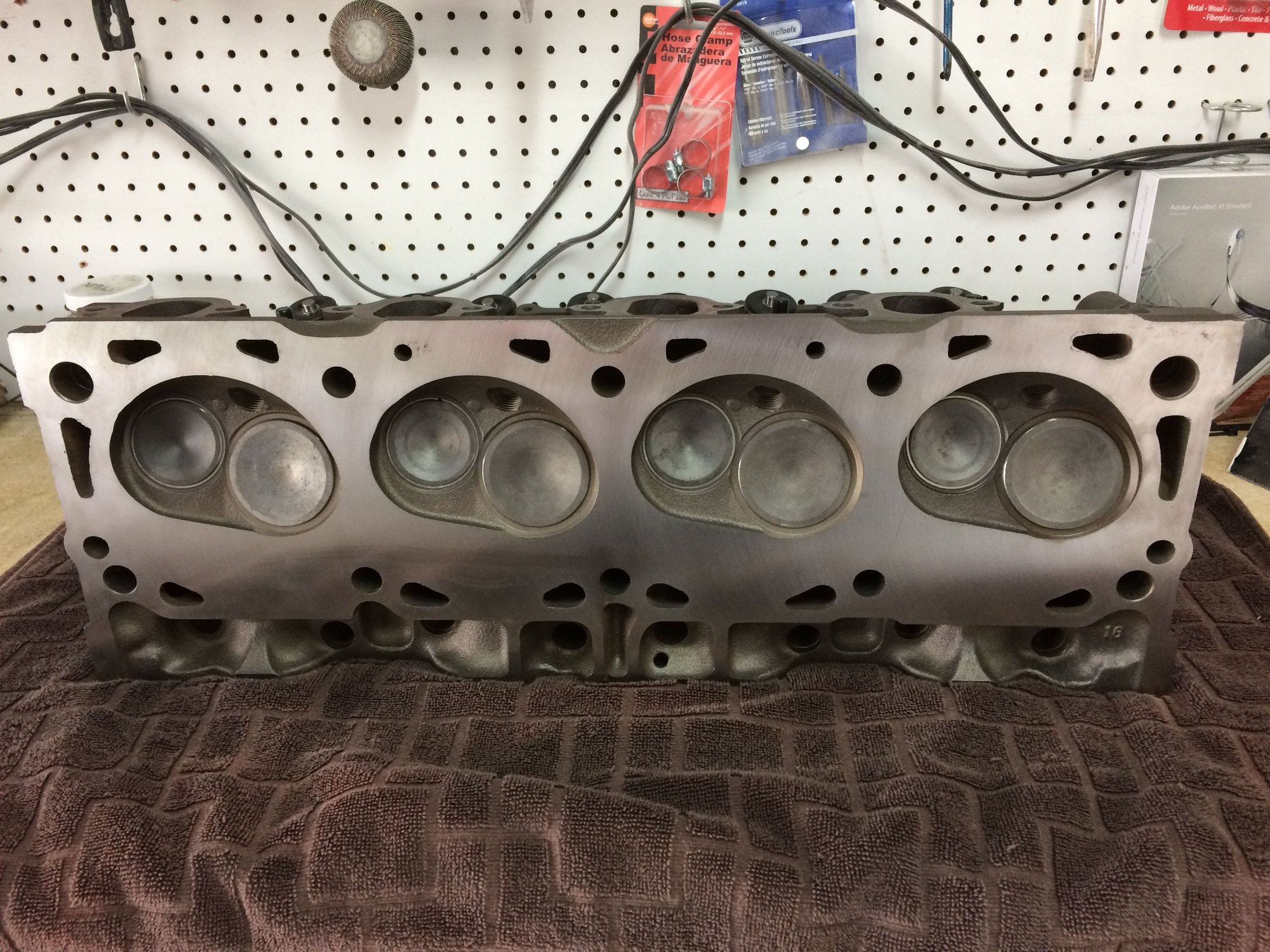

Head ****
Fresh D0VE's
Ahhh... Sexy! Can you say better compression???
C/J Valve size plus, you can see the hardened seats on the exhaust.
You guys may not be half as happy as I am but, I love the old iron heads. Had these D0VE's rebuilt with hardened seats, bigger valves, 7/16 ARP's, Rod guides, 3 angle cut, matching springs to the cam, etc...
Onto the build. I have the iron SCJ intake with Holley spread bore, cam, these heads, 0 degree double roller, new hardened pushrods, hydraulic flat tappets, and possible newer and fresher bottom end. Should wake up my sleepy old 460! I already have the MSD 6AL and HEI distro and QFT 750 Slayer carb.

Nice Heads !! If you don't mind me asking how much money do you have wrapped up in the heads? How much to do the hardened exhaust seats? What size valves did you go? I need to get my heads done on my '76 460 motorhome before I drop a valve.
Looking forward to your build. Keep the photos coming!!

Dang if those springs don't look pretty durn clean!
