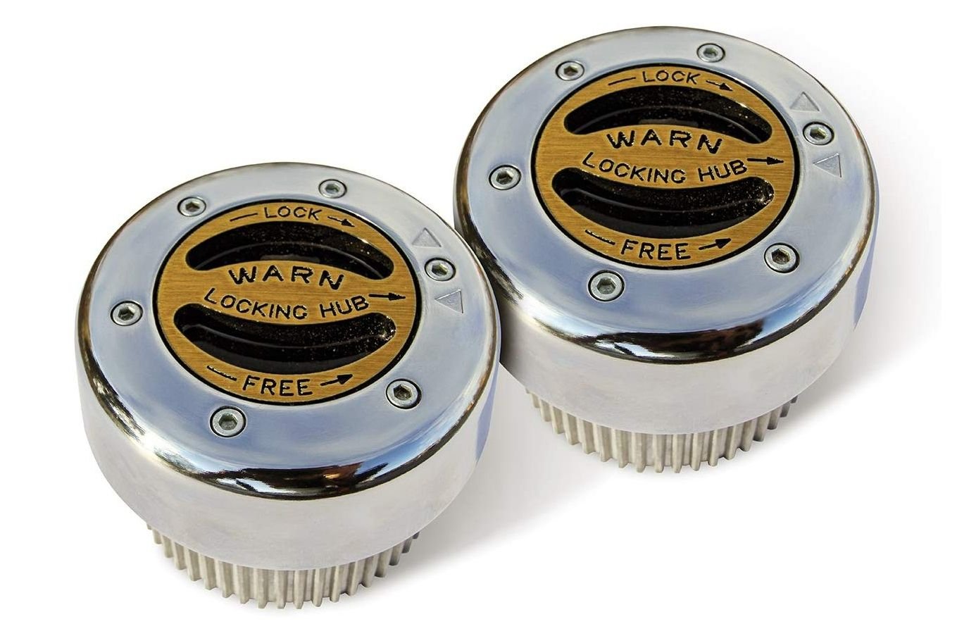

What year are we working with? Must be 99-04 since they are junk. These are the last ones I installed for a customer and he loves them. No auto but He doesn't care about locking them manually. They are a simple install and super smooth.
WARN 38826 Premium Manual Hubs WARN 38826 Premium Manual Hubs

I always went with the Premium. They are robust and limited amount of plastic.
As far as MileMarkers, the only experience I've had were using Supremes on Jeeps and they were very comparable to the Warn Premiums.
