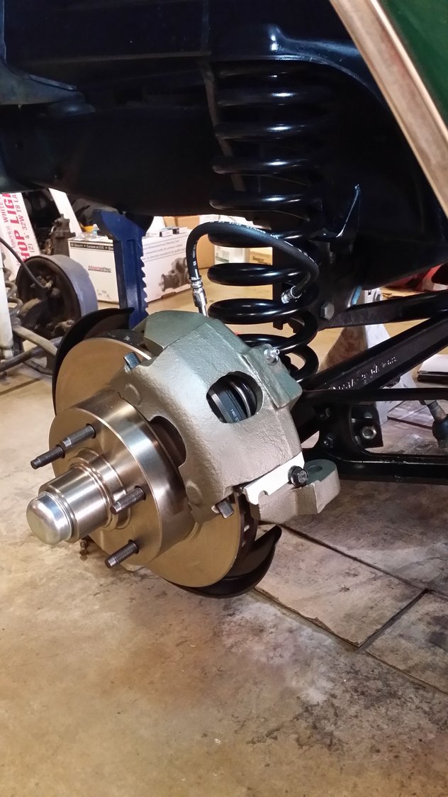

Discs have numerous advantages over drums and if your truck is a '65-later F100, a disc brake front suspension from a '73-'79 F100 or from a '75-'79 F150 is a direct swap onto a '65-'72 F100.
I installed a disc brake front suspension under my '69 F100 that I pulled from a '77 F100. The initial wrecking yard donor parts weren't that expensive and I purchased all the new replacement parts a group at a time until I had everything needed to rebuild the suspension/brakes and then install them on the truck.
The power discs are a vast improvement over the old drums my truck came with.
