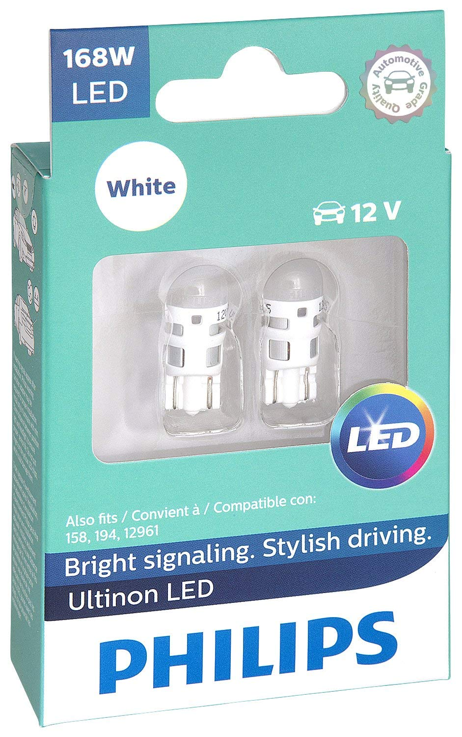

I used these but took off the plastic dome over the LED. Works like a charm.
Philips 168 Ultinon LED Bulb (White), 2 Pack
